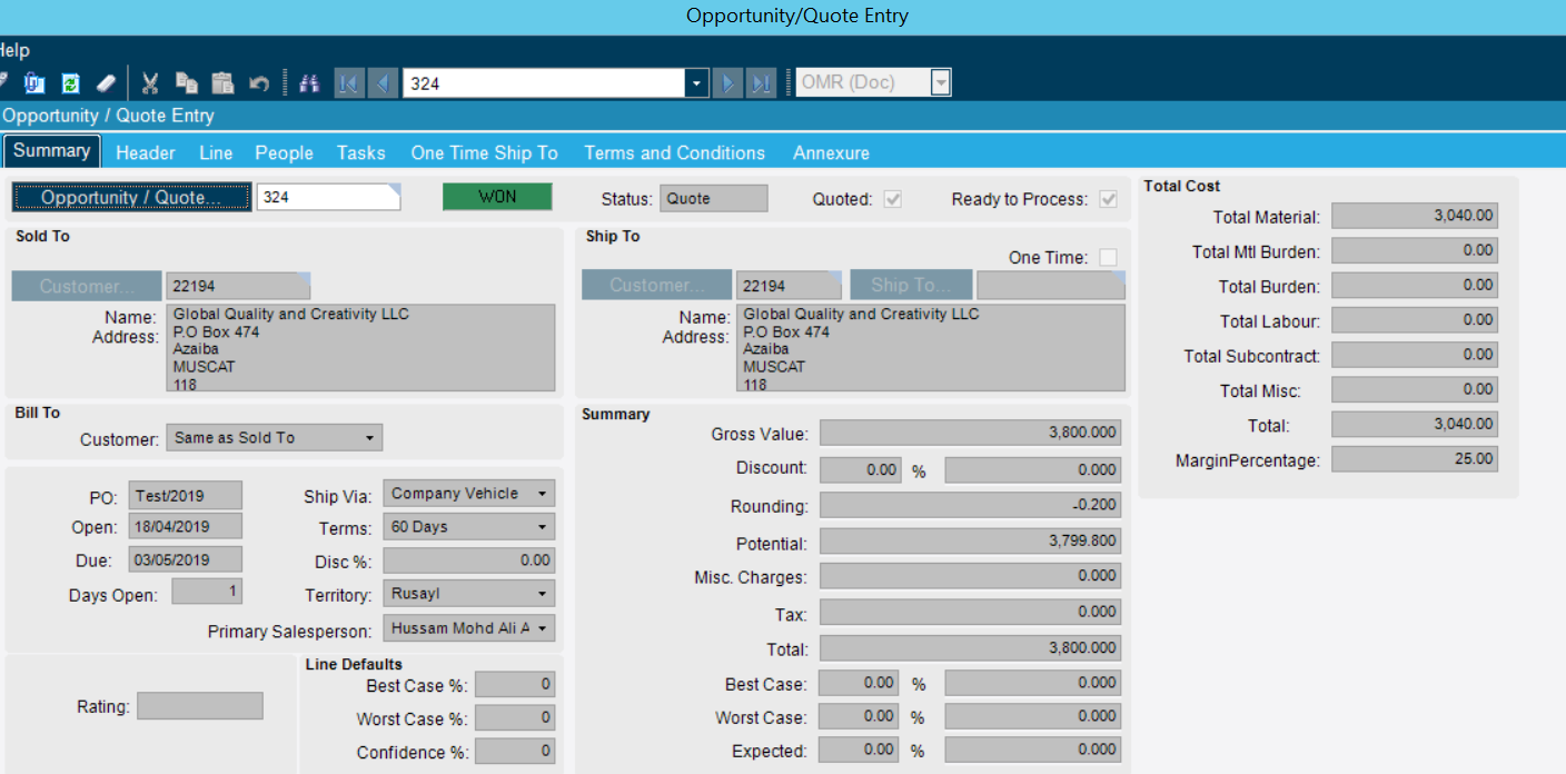

Those are temporary , work fields that only exist during the calculations done in the Quote/Opportunity Entry Screens. You can capture those fields with a customization in Quote/Opportunity Entry to new UD fields in QuoteQty. Or you can write custom code to calculate them in your data directive. I’ve tried that and I can come within pennies of the amounts displayed on the worksheet tab but I’ve never been able to capture it exactly. The MatlBurden cost always seems to be off. If you figure out the best place to put it I’d love to know. Good Luck
Dear Michaelpalecek,
I have done same customization in Summary tab refer to below screen
Are you want same like this?
