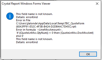

I used the formula you suggested. When I ran the report, I received the following error.
