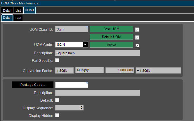

Edit - For the UOM stuff (I’m not experienced in this part at all) but wouldn’t it be something like this -

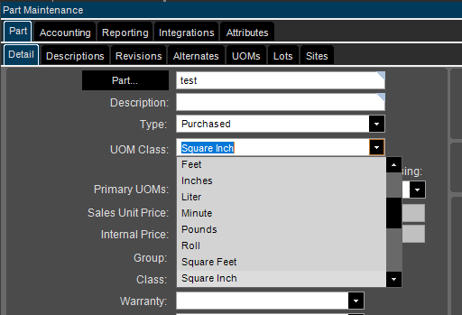

Then on the part level -
There’s probably additional setup required for the UOM class to be correct but I think that’s kind of the path you would go down… And as long as the parts have the UOM as Sqin then when you bring in the part in Quote Entry it will default to that
