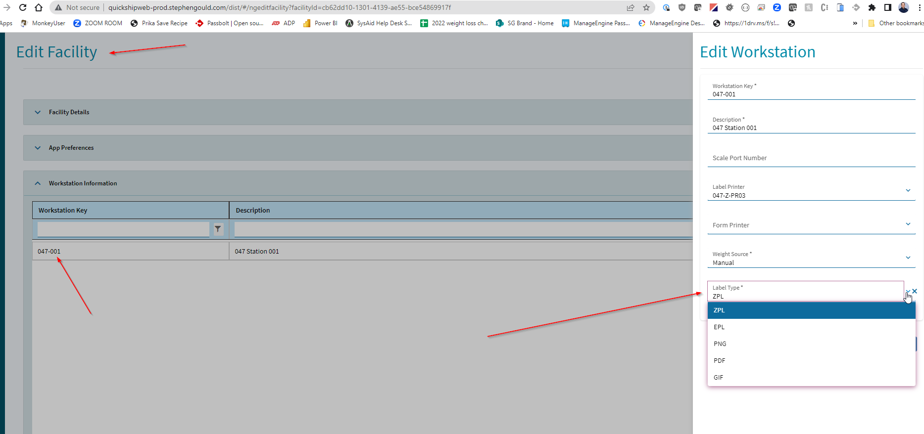

Mike you can change the Label Type in the workstation within QuickShip

@josecgomez Yeah - I tried that. From my installation tech, the process is that the label (ZPL or EPL) format are the only two formats that Fedex/UPS will return from their web service. We tried asking for PDF and it failed. We you guys able to make that work? Maybe I missed something…
No we have actual Zebra Label Printer… that’s dumb that it doesn’t work.
