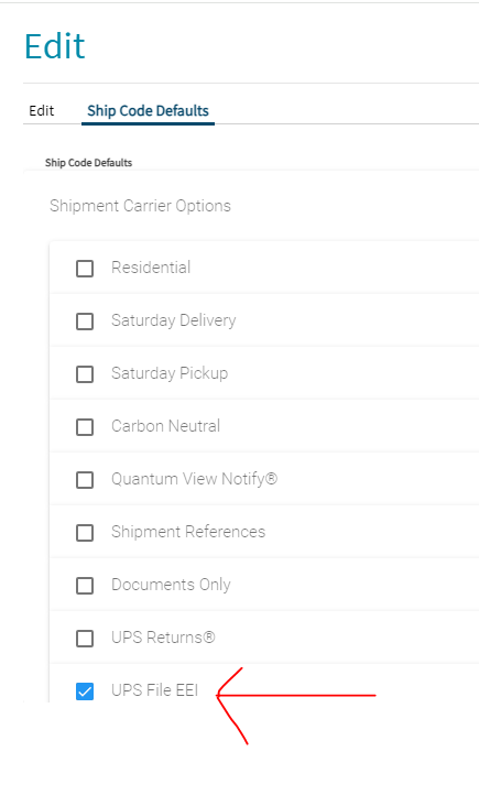

Do you or anyone else know if Quickship automatically sends the Invoices electronically to UPS or what settings need to be configured to do so?
Max
The data is sent to UPS and FedEx when the packages are created and we manually close carriers nightly in QS. I am not aware of an auto close.
There are settings that need to be in place.
In QuickShip under Setup / ShipCodes. Find ship code and edit ( Pencil icon).
Ship Code Defaults tab… Shipment Carrier Options and check UPS File EEI.
Hope this helps.
I forgot to mention, when EEI is sent to UPS, on the bottom right of the printed UPS Label, there will be " EDI " . This has been confirmed with a UPS International Account Manager.
