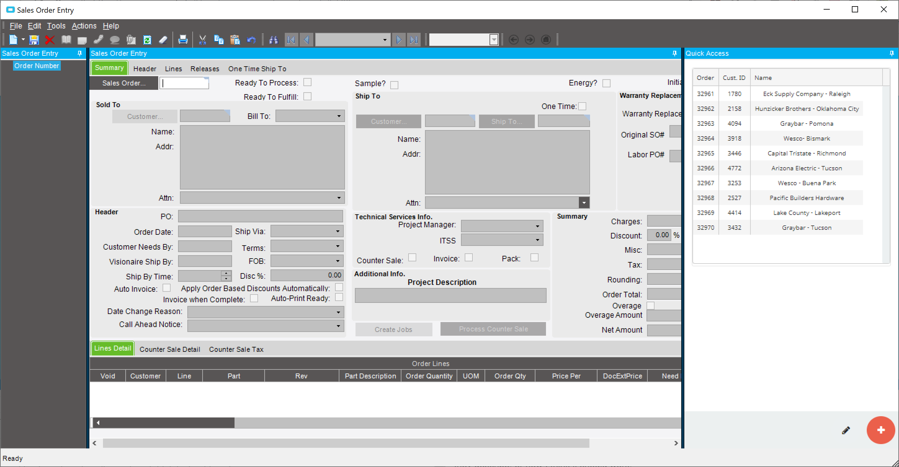

I also see the value of this feature and have set up my first, as you said in Order Entry.
I created a BAQ, trying to duplicate what the limited help describes, just a simple BAQ to show the Latest 10 Orders for the customer. BAQ and EDD Dashboard item created sucessfully, but is not working how they describe, or how I think it should work.
I am expecting that when I open a Sales Order for CustID# 2517, the EDD item will display the last 10 Orders for that customer ID, but I am not sure how it passes the information to it.
When no Sales Order is entered the chart (which is just a grid list) displays all the last 10 Orders in the system regardless of Customer ID, but when I enter a new or Existing Order, it goes blank.
I tried adding the Customer ID to the Filter, but same.
I am expecting to see 10 items all for CustID# 2517 but get this:

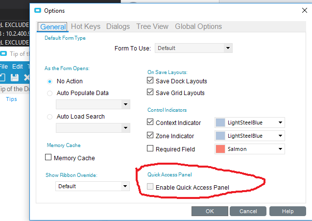

It isn’t obvious and sadly I just found that is is not referenced in the general help for the panel, but you can set it up to always option using the options menu for a form. When you have a form open go to tools + options on the menu and check the Enable Quick access panel checkbox in the lower right. That will cause it to start on.
options
