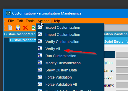

Comparing the code from one system to another isn’t any faster than running “Verify All” in customization maintenance.

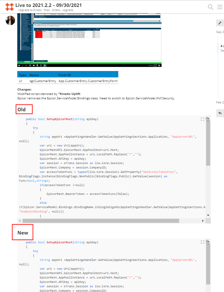

What we did for our upgrade was as follows
  1. Upgrade System
  2. Fix Customization and write documentation of what was fixed (code snippets that were changed etc)
  3. Repeat Step 1 and apply “notes” from Step 2 as needed

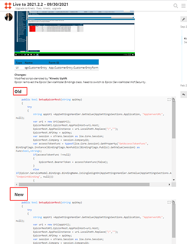

That worked rather well because any changes that were made on the production system were generally cosmetic (or new functionality) so we were able to quickly go to the spot in the code where we had made tweaks and copy / paste in our changes. See below from our documentation.
We notated what was there Old and what we changed “new” then we are able to quickly jump back and apply the changes. This makes it so that any UX changes (moved buttons around) don’t have to be re-done and it allows us to quickly iterate.
I suspect your approach of comparing Code is going to be quite difficult both to implement and to execute because just a few extra spaces in the wrong place and your entire document will look “changed”
Obviously you do you but just throwing out there an approach that worked well for us and allowed us to be flexible and nimble without over-engineering.
PS: yes our documentation system is Discourse :sheep: :grin:
