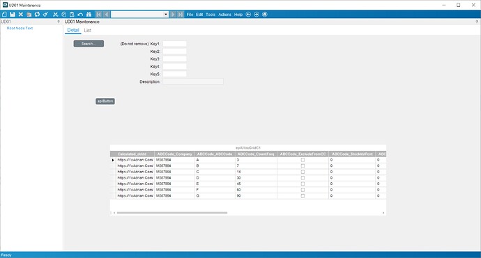

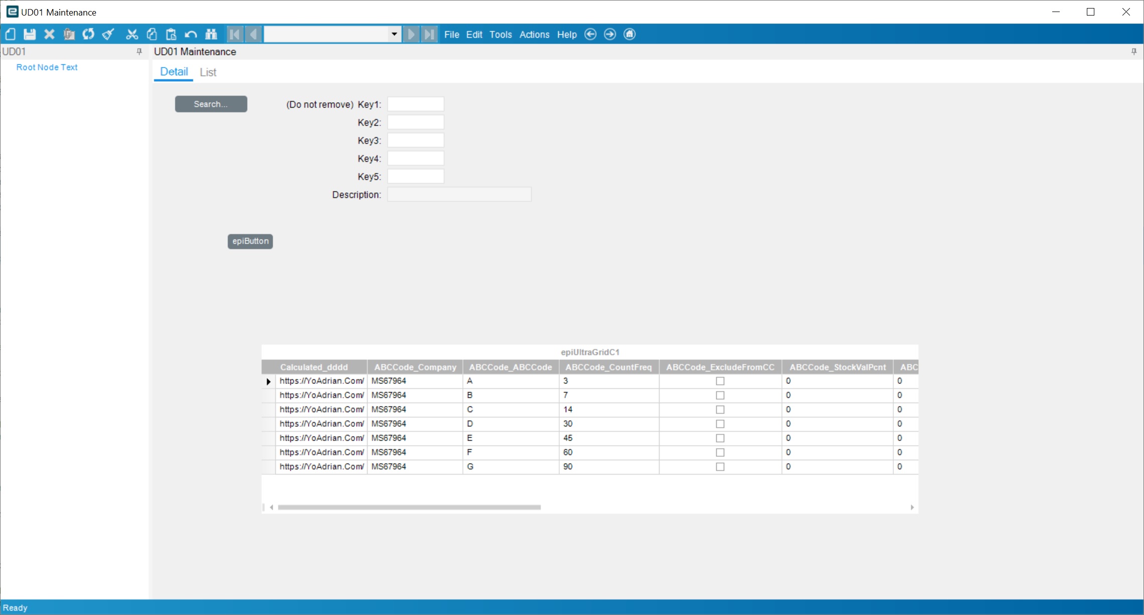

Calling it from client code:
//References:
//All should already be in client directory. Choose all files to see them.
//Epicor.Ice.Lib.RestClient.dll
//Ice.Core.Session.dll
//Newtonsoft.Json;
using Ice.Lib.RestClient;
using Ice.Core;
using Newtonsoft.Json;
private void epiButtonC1_Click(object sender, System.EventArgs args)
    string restApiKey   = "Your APIKEY Here";
    string libraryName  = "JMyers56";
    string functionName = "CallBAQ";
    var functionInputParameters = new RestContent(
    new
        baqName = "aaaa"
    var restClient = new RestClientBuilder()
        .SetDefaultApiKey(restApiKey)
        .UseSession(oTrans.CoreSession)
        .Build();
    var response = restClient.Function.Post(libraryName, functionName, functionInputParameters, published: true);
    var responseJson = response.GetJsonResult();
    DataSet resultDS = JsonConvert.DeserializeObject<DataSet>(responseJson["baqOutput"].ToString());
    epiUltraGridC1.DataSource = resultDS;

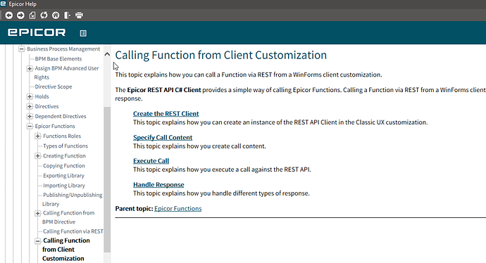

Open Epicor Help.
Search for “Calling Function from Client Customization”
