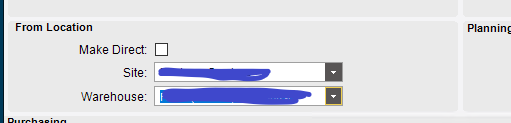

Develop a BPM to update JobMtl Warehouse based on OrderRel warehouse. Epicor picks this warehouse first and if the stock is not available, then it picks from other warehouse.
