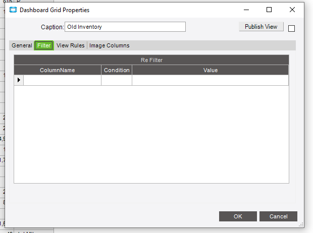

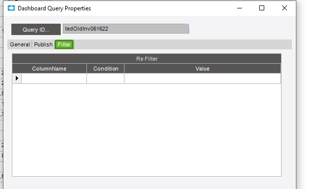

I’m not filtering results on the query:
nor am I filtering the grid itself:
This is a brand new dashboard with nothing else. I started completely over in case I had done something and forgot to change it back, but this involved rewriting the query from the start, and then creating a new dashboard using that query.
If I open the query using this:
It still gives different results than it does in the dashboard. Any ideas or can someone point me in the direction to look?

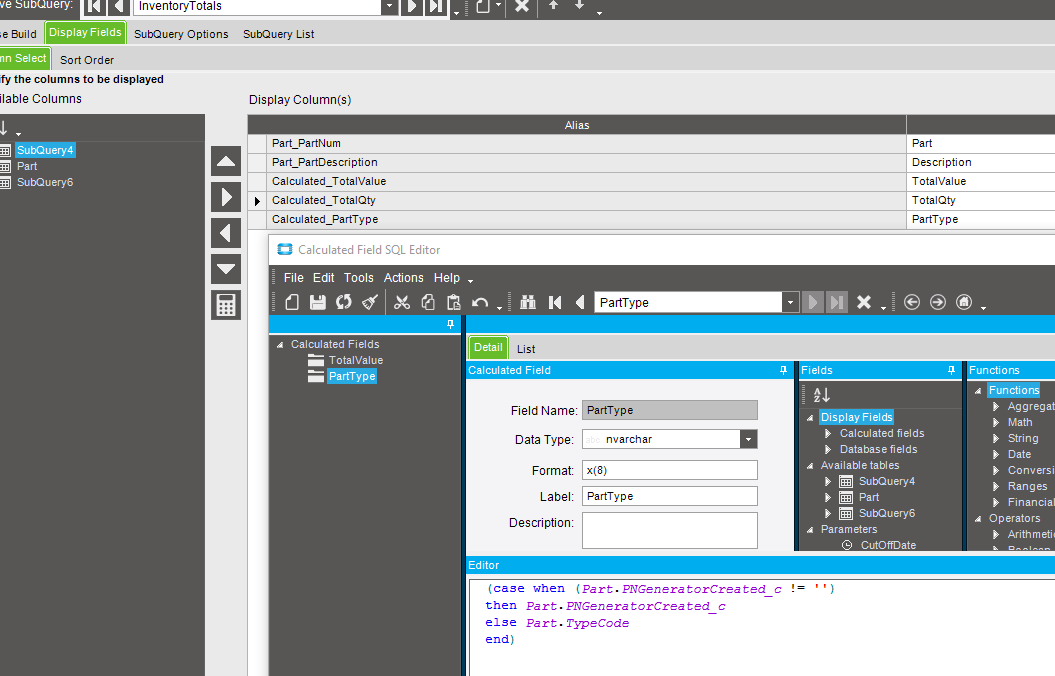

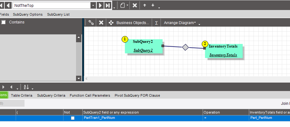

It’s really messy and 7 layers deep. If it helps, the goal is to find old inventory that hasn’t been used by a parameter date and its value.

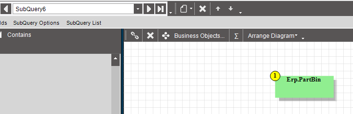

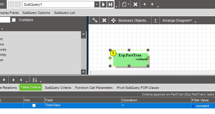

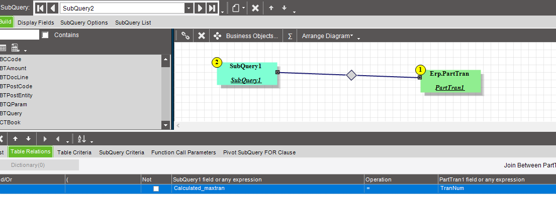

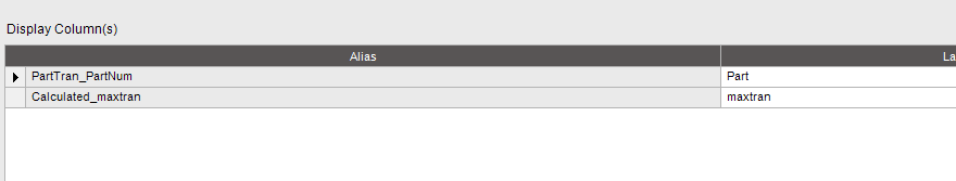

I’ll post pics, but once again messy and not labeled well as I was recreating one I had already done:

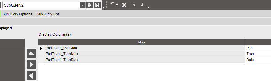

This subquery is used to grab the max transaction number from PartTran for a specific part. This is then fed to the next query to find the date of that last transaction.

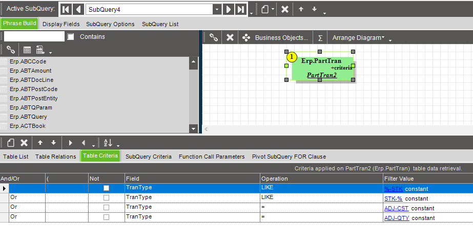

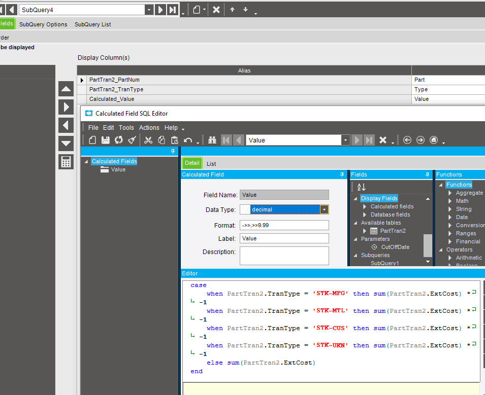

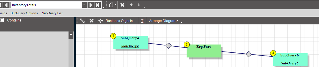

This query limits part tran types to be fed into another subquery to help determine the value of the parts sitting on the shelf:

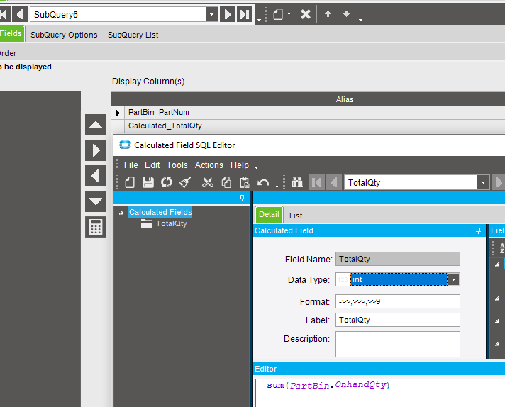

This subquery is also fed into the one to determine inventory value and totals the number of parts in various bins:
This brings those two queries together along with part to get the description and part type based on a UD field and part type as the back up. It also sums up the total value. The links are all on PartNum.
Then I’m combining our max transaction date with the part value:

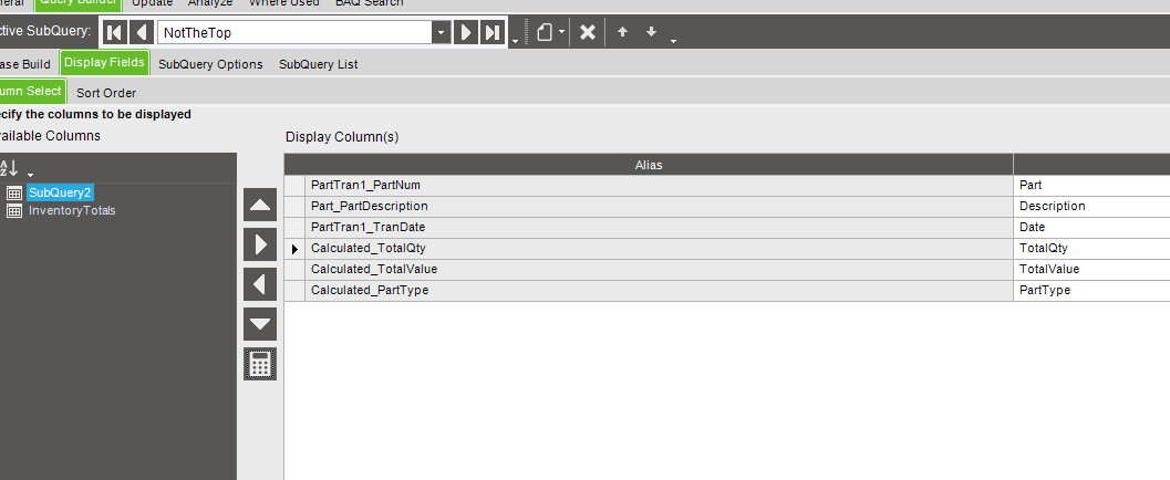

Top level simply cuts off those whose max transaction date is after the cutoff date:

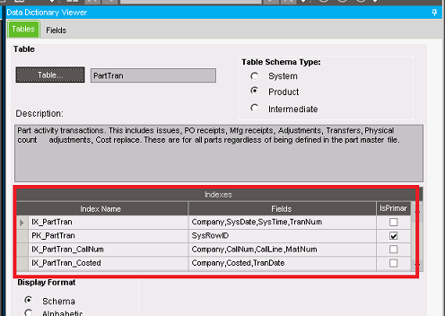

  • I didn’t see a company field in your queries/subs - I always include company in my queries
  • and with PartTran I always include index fields too… except where I can’t because of grouping/aggregation
    e.g. from data dictionary

So I was only able to add the index fields to a single one of the queries (subquery 2) and could not carry that any further or use it anywhere. I added them to the Display Columns for that single subquery and didn’t use them anywhere else or even move them further along because of aggregation issues.
So, using any kind of reason or logic, shouldn’t fix it. But this is Epicor. Problem solved. Thank you so much for your help. Very much appreciated.
