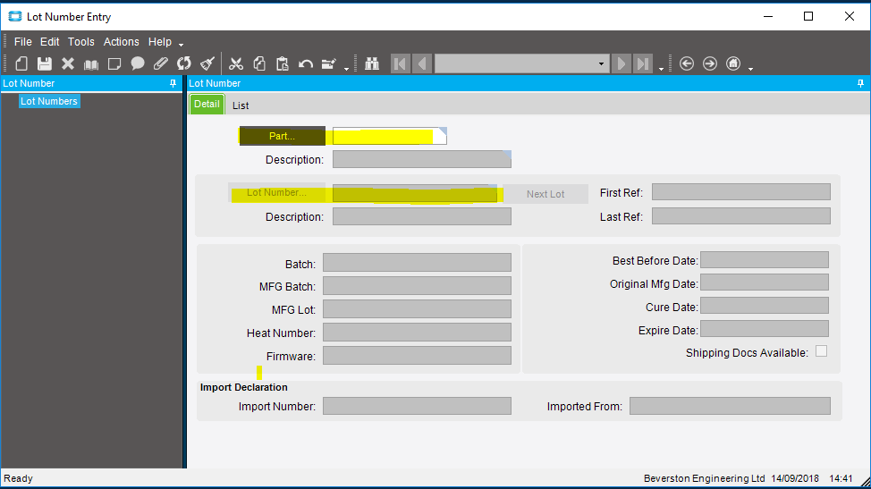

add UD filed in Lot Entry, so when booking material in (for purchased material) or booking to stock (for manufactured parts) BPM to remind or/and force users to enter the manufacturer ID for the lot.
at issue material to jobs, BPM to compare each material Lot manufacturer ID and the assy# approved manufacturer list on the assy#=part level (using JobHead.PartNum, and RevisionNum), to validate and allow only if Material lot manufacturer ID is one of the approved manufacturer list.
