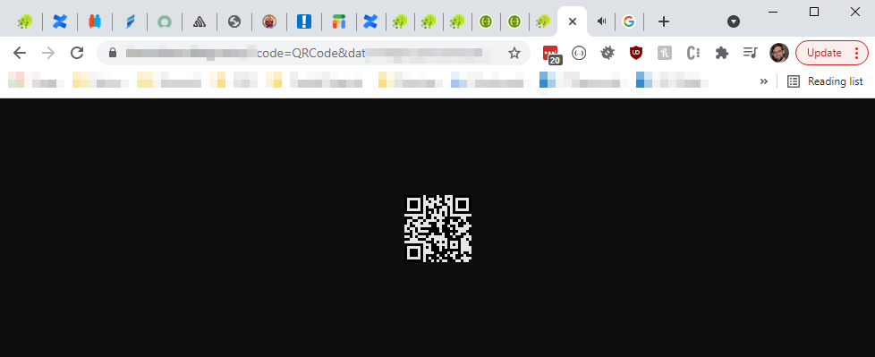

In crystal or SSRS land I use a small web service we host that runs a single PHP script. We just return image document headers and the generated image for 2d codes. For the image location object in crystal or SSRS we just use a URL like this https://mybarcodehost.local/?code=PDF417,4&data=SomeBarcodeData
This is the entire index.php file just requires that tcpdf library. Example 050 : 2D barcodes (QR-Code, Datamatrix ECC200 and PDF417) · TCPDF
<?php
require_once ("tcpdf_barcodes_2d.php");
$code = $_GET["data"];
$type = $_GET["code"];
$barcodeobj = new TCPDF2DBarcode($code, $type);
$barcodeobj->getBarcodePNG();
It’s fairly old PHP code, but for a quick internal service to give me 2d barcodes anywhere it’s good enough.

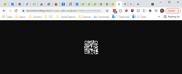

Here is a real life result of that system from a report of our as a QRCode
Copy pasted version of the generated image as QRCode H
