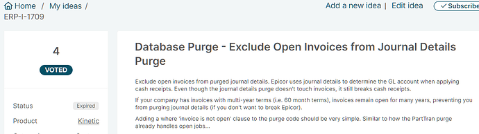

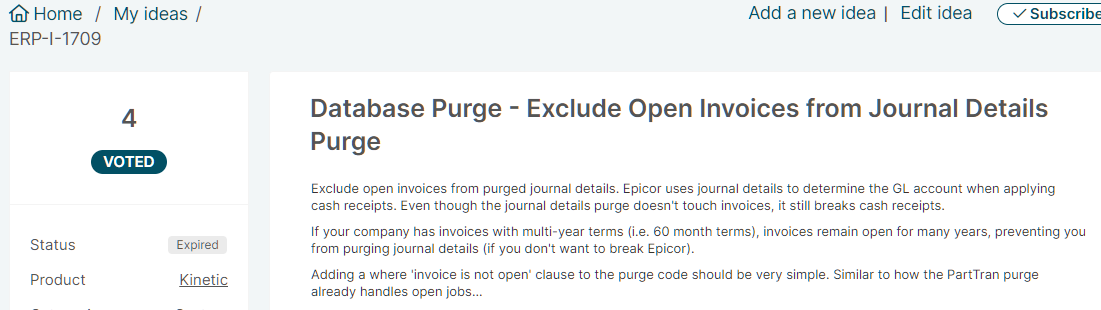

Epicor’s journal detail purge also them for open invoices too, which requires us to run a data fix for each invoice (one at time, oof!). Should’ve been a quick fix to add a condition for Invoice Closed=TRUE…
Here’s my expired idea:
https://epicor-manufacturing.ideas.aha.io/ideas/ERP-I-1709
