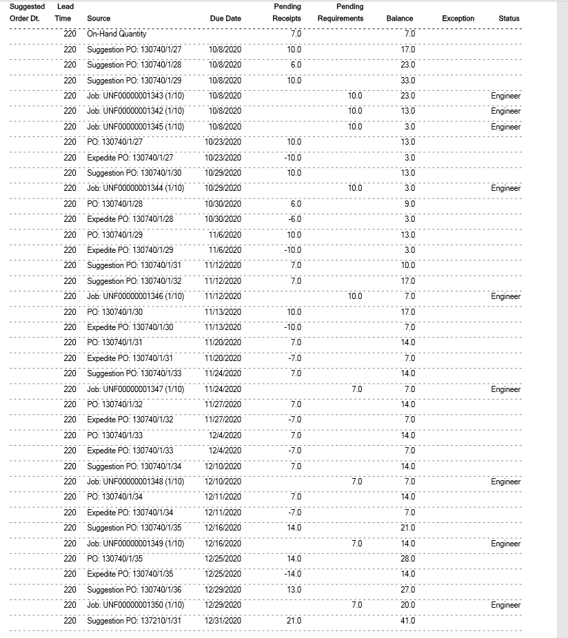

Reaching out to the folks here to see if anyone has seen anything similar. I’ve attached the time phase screen showing what the system is doing.
This is a significant issue, if we honored these suggestions, the increase in inventory would be 1/2m. Not acceptable.

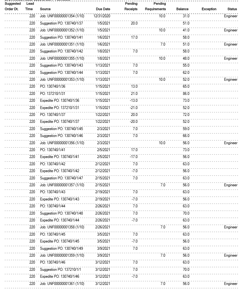

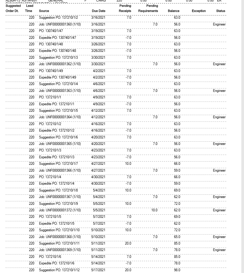

Thanks in advance, great community here. Had to limit the time phase views due to our data restrictions (can’t publish part numbers publicly), but it shows three consecutive pages that illustrate the inventory growth.
All PO’s have quantities locked, but dates unlocked. Checked that already.
My quick observation is that you have all unfirm jobs where your POs aren’t meeting the dates of when the jobs need to start. Your PO dates maybe locked but if you don’t have the demand at the time the jobs need it, you will get a suggestion.
Also, what are the parameters that you have set for Safety Stock and Min On Hand? Do you Days of Supply set up for this material? Is your lead time for this material actually 220 days?
The dates are not locked on the PO’s, only the quantities. The material is not constrained. The expectation (and it works this way on almost all of our parts) is that Epicor will suggest lining up the dates in the best way possible while keeping inventory within parameters (in this case, no safety stock, no min on hand, days of supply are zero). We generally run this part weekly, and want material signals aligned with that plan. The jobs do meet need, but the material dates don’t line up with the job start dates. Inventory keeps growing (if we followed the suggestions).

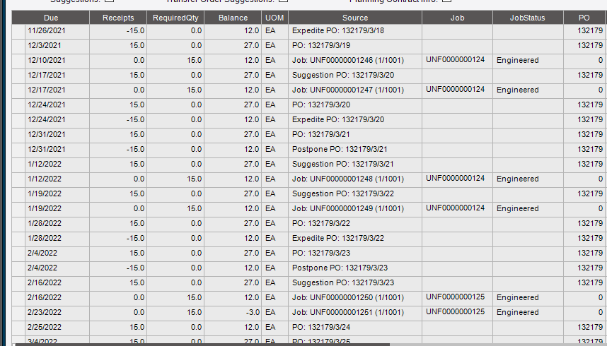

Snip below is of a part that works properly. The 12 piece carryover is expected, we run this part in fixed quantities of 15. What would not be acceptable is a constant buildup of inventory, which is what we are seeing on the item in the original post.

Happy to help, Gil. From what I am seeing, the issue is being caused by the PO material coming in later than when the job needs them. It is masking the real issue (see below). You posted 3 pages but I’ll bet there is more than that.
Also, I noticed that your purchase order quantities didn’t match the job quantities. I would suggest that the PO order release quantities match the unfirm job quantities (they don’t). I believe that is where the extra material is coming into play, not the PO suggestions. The PO suggestions are the exact quantity of the PO it references, then there is an expedite PO suggestions to reduce the quantity. So the PO suggestions are really for expediting them.
Are any of the PO suggestions new PO suggestions. Looks like they are all expedite suggestions. Any super long receive times? Have you run generate PO suggestions with the Regenerative option and gotten the same results?

In the first one you posted though, the PO quantities change and don’t match up with the job quantities. The second part has matching job quantities and PO quantities.
Beth – I unlocked all the PO quantities and dates, and re-ran MRP. The excess inventory went away.
From what I can tell, it is possible that the misaligned incoming material quantities accumulated over time. I just don’t understand why it doesn’t self-correct – in the environment we are describing, the overage should be no higher than the locked PO quantity, and that inventory should bleed down until the next demand brings us below zero. Then, the next release should schedule to come in for that need (even if it is a few pieces heavy).
