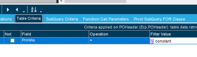

One easy way would be to create a BAQ with the POHeader table, with the table criteria
PrintAs = N
You could create a dashboard, or even add it as a BAQ grid on his home screen.
This is exactly what I did to quickly find other issues, I just didn’t know if there was a way in the system that already existed.
