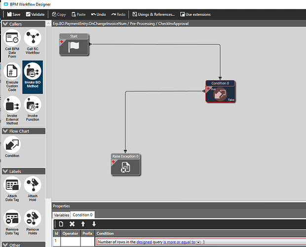

I’m trying to create a method directive on BO.PaymentEntry but I wanted the condition to reference a UD field which I placed on APInvoiceHed.
Does anyone knows how to achieve this?
Thanks in advance!
What you can do is create a BAQ that retrieves the UDfield for the row you are working with and use the Dynamic query Business Object to call it. Here’s an example of one I’ve done using some code.
You’ll need to include the Ice.Contracts.BO.DynamicQuery Business object in references.

Alternatively you can use the Invoke BO method widget to call the GetQueryExecutionParametersByID and ExecuteByID methods to do the same thing as the above code snippet
