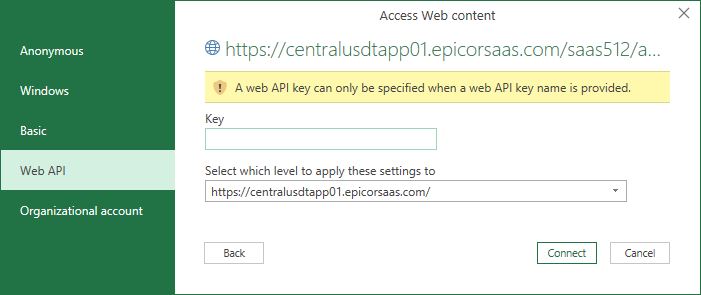

So is there a solution? Is there a way to pull BAQ data from a REST v2 API into Excel? What is the process? If I use PowerQuery Editor, what is the code to put in there. It kept saying that I need an API key name. My key name is OJEXKey, and my BAQ is named OJEXForDash. Every time I tried to put it in someplace, it wouldn’t accept it. Similar to this issue:

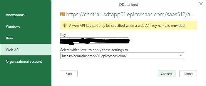

I went to Excel > Data > Get Data > From Other Sources > From Odata Feed…
Left it at basic and pasted my URL: https://centralusdtapp01.epicorsaas.com/saas512/api/v2/odata/VTAERO/BaqSvc/OJEXForDash/Data
Unable to connect We encountered an error while trying to connect. Details: "Access to the resource is forbidden."
Retry, Edit, Close
It never asks for my API key with this method.
I went into manage data sources and deleted all my old global permissions that were leftover from me trying and failing to get this to work.
In this window I can’t get it accept the API key.
If I have to add the api key name, what is the syntax for that?
Also, should I choose the “level” that include my BAQ name and /Data at the end?

I tried adding this to the connection but still get the same errors. Either anon connection is not allowed, or I have to enter an API key, which keeps saying I need an API key name. Also tried the whole website string with the api key in Excel’s -webservice() formula, but still returns nothing (value).
The only way I have ever gotten this to work is to get data “From Web” instead of “From oData Feed” in Excel. Using the oData Feed always gave me an error.
I get the same kind of error using the web data source in excel. What do you paste in there as a connection string? Do you include your API in the address? Do you include the API key name in the address?

After you enter that, the next window asks for a way to authenticate. It won’t accept anonymous and using basic forces you to enter a username and pw. I thought the whole point of API key and v2 REST was to avoid the username requirement? If I choose WebAPI, I am back to where I started.
Excel edits URLs and strips away all query strings. You have to use REST v1.
