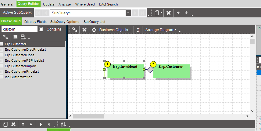

If you’re just looking for the raw data, another option could be to just make a BAQ. You can set up a pretty simple query to get the count of invoices per customer. You can incorporate your part costs into a similar query to compare with the invoice’s cost to get an idea for profit.
Here’s a little something I was messing around with for the invoice counts:
You can add a date filter to the InvoiceHead to better suit your needs.
Thank you so much - that is perfect. Sorry I knew it was potentially relatively simple but couldn’t quite get it right!

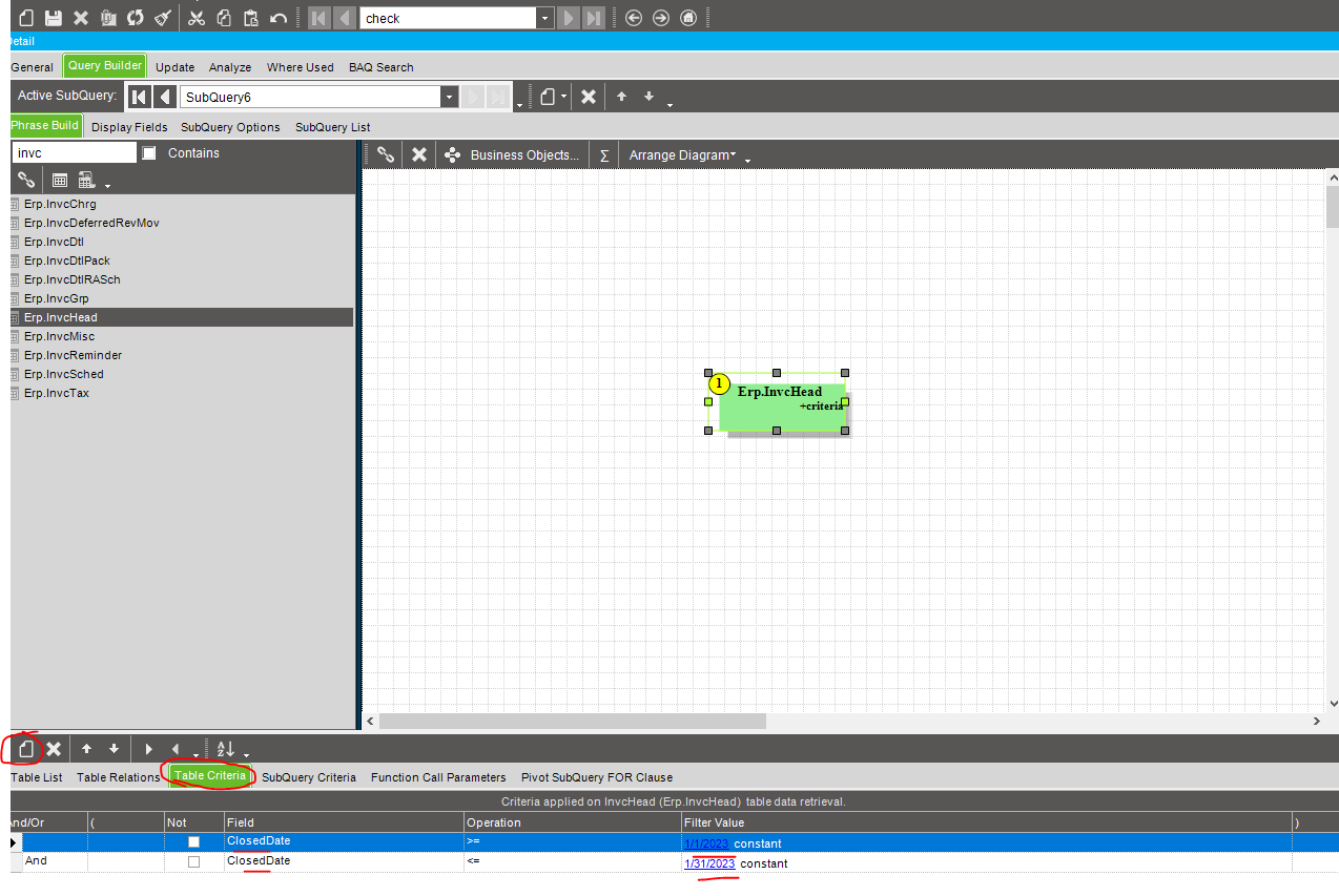

How/Where do I add the Date Filter to this? If I am trying to build a data query for number of invoices processed in One month
In the “Table Criteria” section if you are using the BAQ designer:
Amazing, thank you very much! Newer BAQ builder and been having some issues. Appreciate the response!
