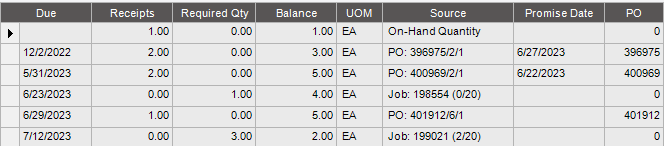

I’ve managed to train Sales to project expected balance for individual parts on a given date themselves using Time Phased Inquiry with suggestions unchecked. This is usually sufficient, but TPI only uses due dates to calculate running balance. Unfortunately, we have quite a few long lead parts that are further complicated by promise dates months past the due date. These are also usually the parts with the most lines of activity to unsnarl before we can get an accurate balance estimate for a date.
IT has been gracious enough to add a new column to use promise date where available or due date when not and calculate a new running balance column by that sort. However, this customization is invisible to Epicor’s scheduling.

Job:198554 will actually reduce our on-hand balance to two. However, Time Phased Inquiry claims we’ll have the four. PO: 396975 is affecting the balance based on due date instead of promise date.
Is the promise date on the Header or Release for 396975/2/1? Do any of the releases on that PO have a Promise Date entered?
Header promise date is blank.
All of the releases have promise dates. That looks to be where it’s pulling the 6/27 date from into Time Phased Inquiry, but it’s not using it in a way that affects balance.
Any chance that release has a partial receipt against it? That does seem really strange that it is not using that date.
A partial receipt would be exceptionally rare as our standard would be to generate a new release for the remainder. This is just an example though. All of our promise dates are ignored by Time Phased Inquiry.

MRP using due dates only and not considering promise dates is the concern that generated the post. This confirmation is unfortunate, but it is what it is.
Thanks for asking the question! I was under the impression that MRP did consider Promise Date, so I am glad I learned the (unfortunate) news.
