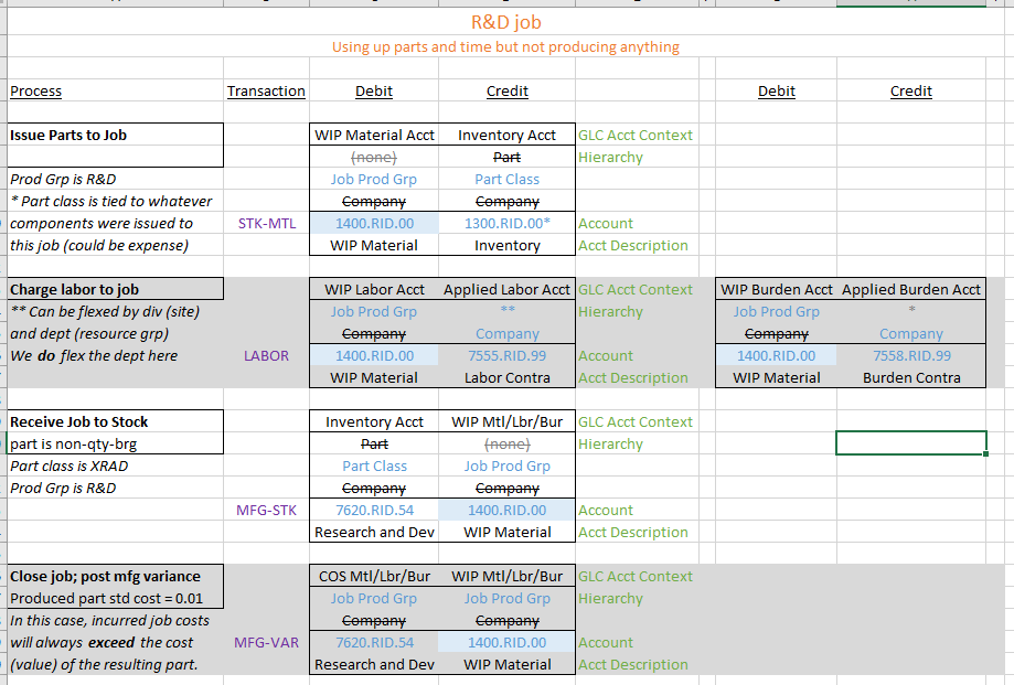

Here is what I wrote internally. Part classes, etc., are ours, of course. There must be something special about the part class we used also…

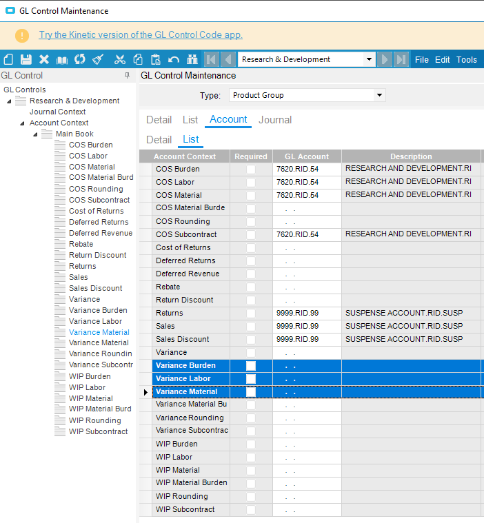

In short, I believe the setup should be as such:
  • Part number and description is whatever you want
  • Part Class is Exp - Research & Development (code is XRAD)
  • Product Group is Research & Development (code is R&D)
  • Std. cost can be anything; it’s irrelevant to this process, but I would like it to be $0.01, personally. I think zero might be just fine, though.
  • The GL Code shown below needs 7620.RID.54 populated into the blue rows (Variance Burden/Labor/Material)
For a technical explanation, see the last picture. I mapped out the debits and credits that happen in the process.
