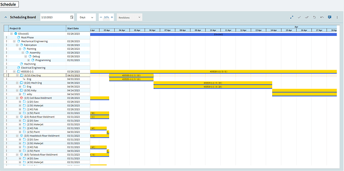

It shows up in the project schedule board, however so do WBS phases, separately. It seems revenue recognition and progress payment billing comes from WBS phases or no?
Wondering if the job that shows up in the schedule bard can be tied to and/or associated with WBS phases or am I not looking at this correctly?
Scheduling - a lot of that is grayed out in the job itself, it seems I can change it in the scheduler board?

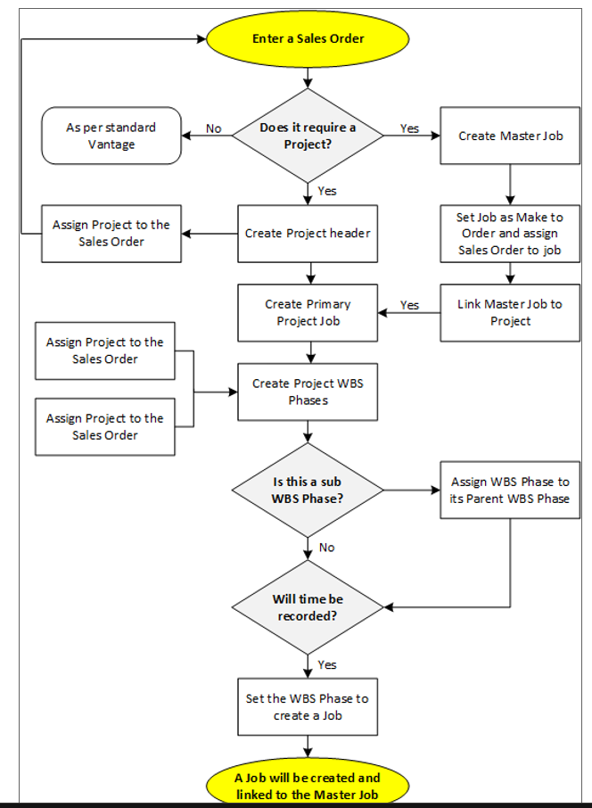

Ok I found this flow chart useful

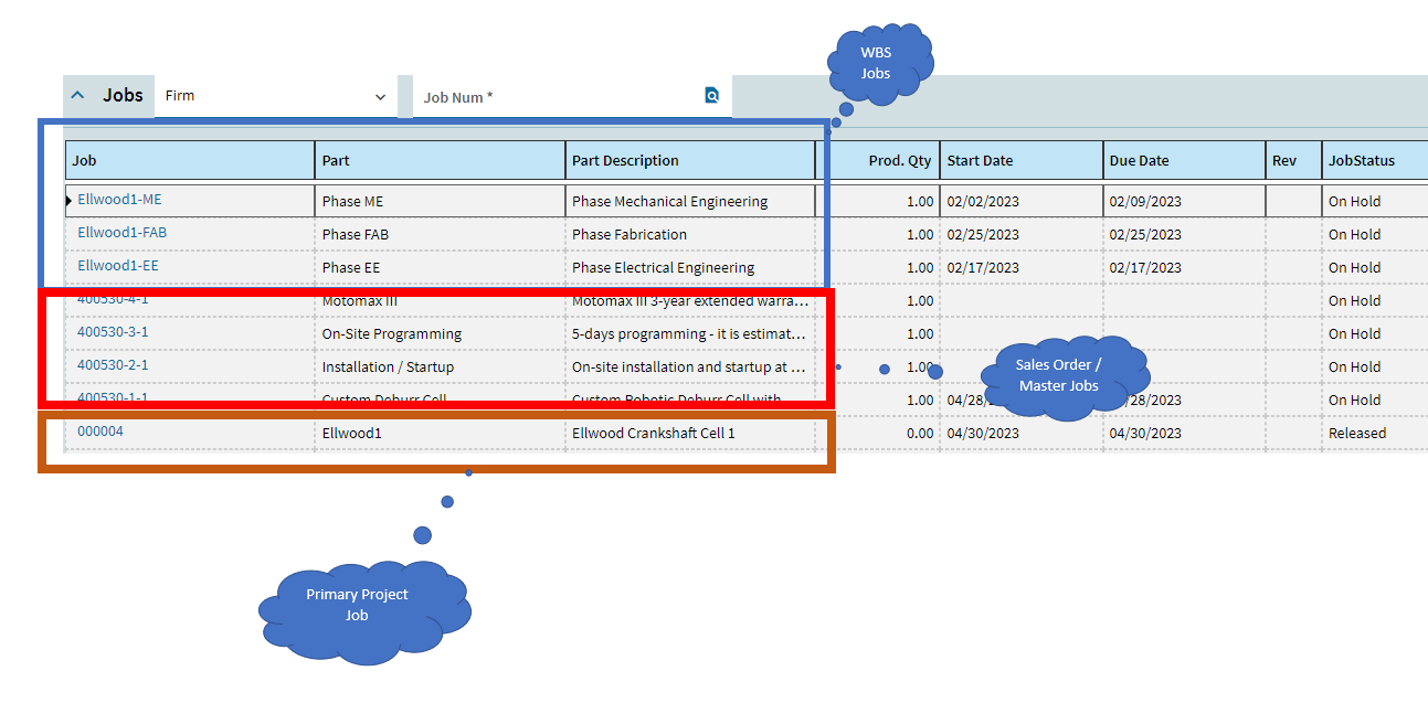

I followed the above flow chart, below is what I have now:
Questions:
1.) Why is the Primary Project Job Prod Qty 0.00 ? I can’t change that anywhere.

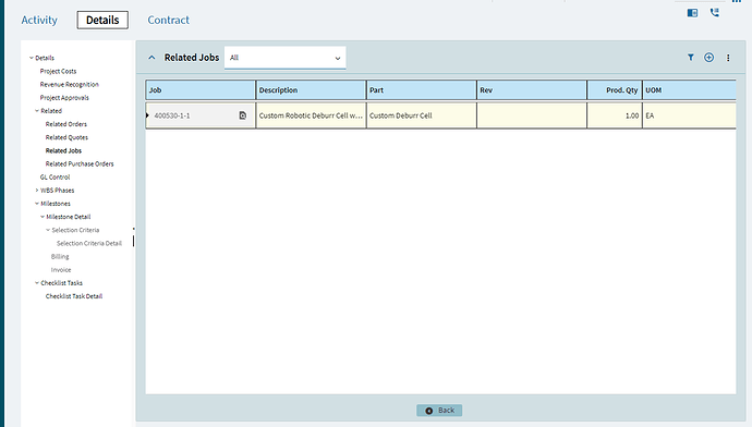

2.) The Master Job is only 1x of the SO related jobs - 400530-1-1
3.) All of the jobs except for the Primary Project Job are “On Hold”, even though they’re “engineered” and “released” / scheduled. Why?
4.) The Start Dates / Due Dates are all over the place. They either don’t match what I originally entered, and if I change them in the Project Schedule Board, they are still all over and don’t reflect what I had input
5.) It doesn’t seem that the project phases have the ability to select predecessors?

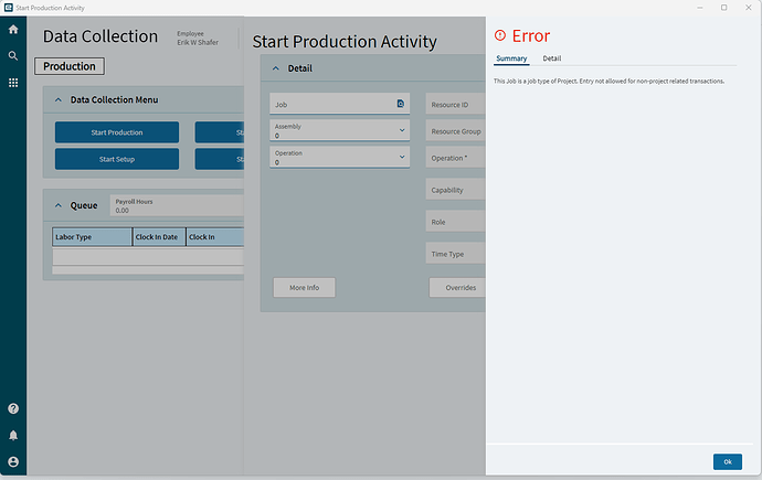

So I have jobs created for a Project, that were created from WBS Phases.
Now I cannot start working on that job through MES, I get an error. It says entry not allowed for non-project related transation.
Why? How can you create a WBS Phase job from a project, and then cannot start production on that job through MES?
Kinetic has four types of jobs:
Production
Project
Service
Maintenance
Each has its own capabilities. You’re already familiar with the production job, collecting costs for production. Service jobs collect the cost of a Service call. Maintenance jobs collect the cost of maintenance requests. And Project jobs collect (and roll up) costs related to Phases and the project.
In your case, you still want to create a production job but add the Project and Phase to the Job header. Users report labor on this production job. Multiple production jobs can flow up to a single phase job.
Separately, the Build Project Analysis rolls the costs up through the WBS.
