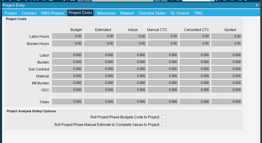

Once you run it, go to the Project Costs tab to see the costs for the entire project:

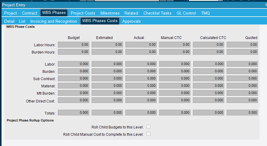

If the PO is linked to a phase of the project, you can look at the costs for just the phase on the WBS Phase Costs tab:
