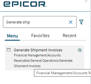

Look at the Generate Shipments process.
You can schedule that in task agent, then the next morning the users can open the specific group and print and post them.
Or Alternatively
Generate the group with Generate Shipment Invoices, mass print (if you have routing setup it could email the invoices), then post them using a process set.

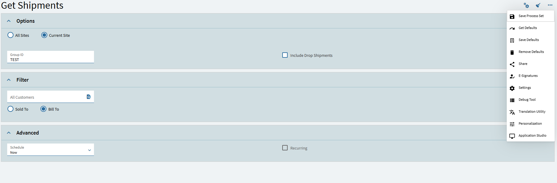

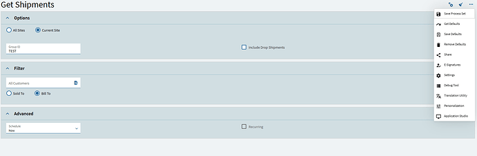

So i setup similar to the below and save the process set and then schedule them like we would have done in the E9 Task Agent?
If you mess up adding each task to the process set you can delete them from the process set maintenance an re add
Will give that a go, thanks.
