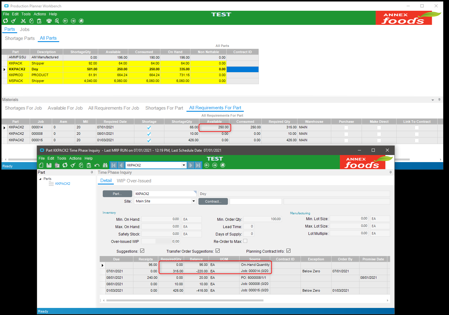

Has anyone else noticed that the Production Planner Workbench totally screws up when you have late to start jobs?
For example, the following part is showing On Hand as the sum of all the jobs required Qty AND shortages are not calculated correctly:
Also, you can ignore the Expedite PO Suggestions, but there is no way to Ignore the non expedite PO Suggestions. This means that production planner will go along thinking all is well, when purchasing has not converted the suggestion to an actual PO… this seems very dangerous to me.

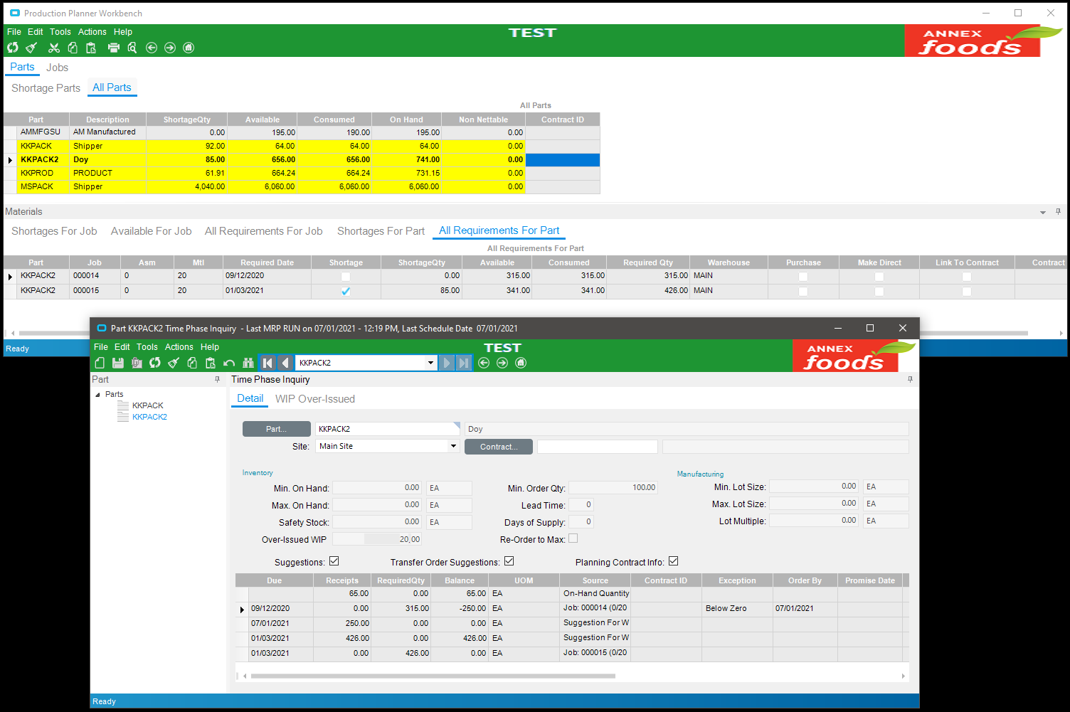

Also, how the heck is the Available Qty calculated? In the following, shouldn’t available be 95 for job 000014:
I really can’t make heads or tails of the calculations in this dashboard. Am I missing something?
Ok. I think I’ve worked it out, but I’m really not happy with the way this dashboard works.
In the first example, the ‘On Hand’ in the ‘All Parts’ section is actually (On Hand + Planned PO Receipts)
In the second example, I had reserved the 95 On Hand to job 000014 so it’s not considered available. The problem is that it doesn’t consider that reserved quantity when calculating the required quantity for the job 00014, so says that we’re short.
It really needs to either disregard the reservations OR subtract them from the job Required Qty OR add to the job Available Qty. :face_with_symbols_over_mouth:
