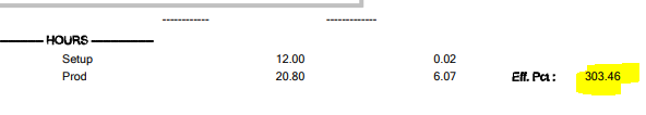

I have been on Epicor for a total of 7 weeks so, please forgive me for what is probably an elementary question. I ran a production Detail Report for a particular Job# to check the efficiency report. But what I am seeing here is a wrong calculated efficiency. I have the formula about how it should work and it goes by
If setup is not complete:
Eff. % = (Earned hours/Actual hours ) * (100)
Earned hours (Setup)= (Est Setup Hours) OR (ActSetupHours) , whichever is less.
Earned hours (Prod) = (EstProdHours / RunQty )* (Labor Qty)
Eff. % = (Earned Setup Hours + Earned Prod Hours) / (Actual Hours ) (* 100)
If setup is complete:
Eff. % = ( Earned Hours / Actual Hours ) * (100)
Earned Hours (Setup) = Est Setup Hours
Earned Hours (Prod) = (EstProdHours / RunQty ) * (Labor Qty)
Eff. % = (Earned Setup Hours + Earned Prod Hours) / Actual Hours * (100)
Also, almost for all jobs run qty and labor qty are same.

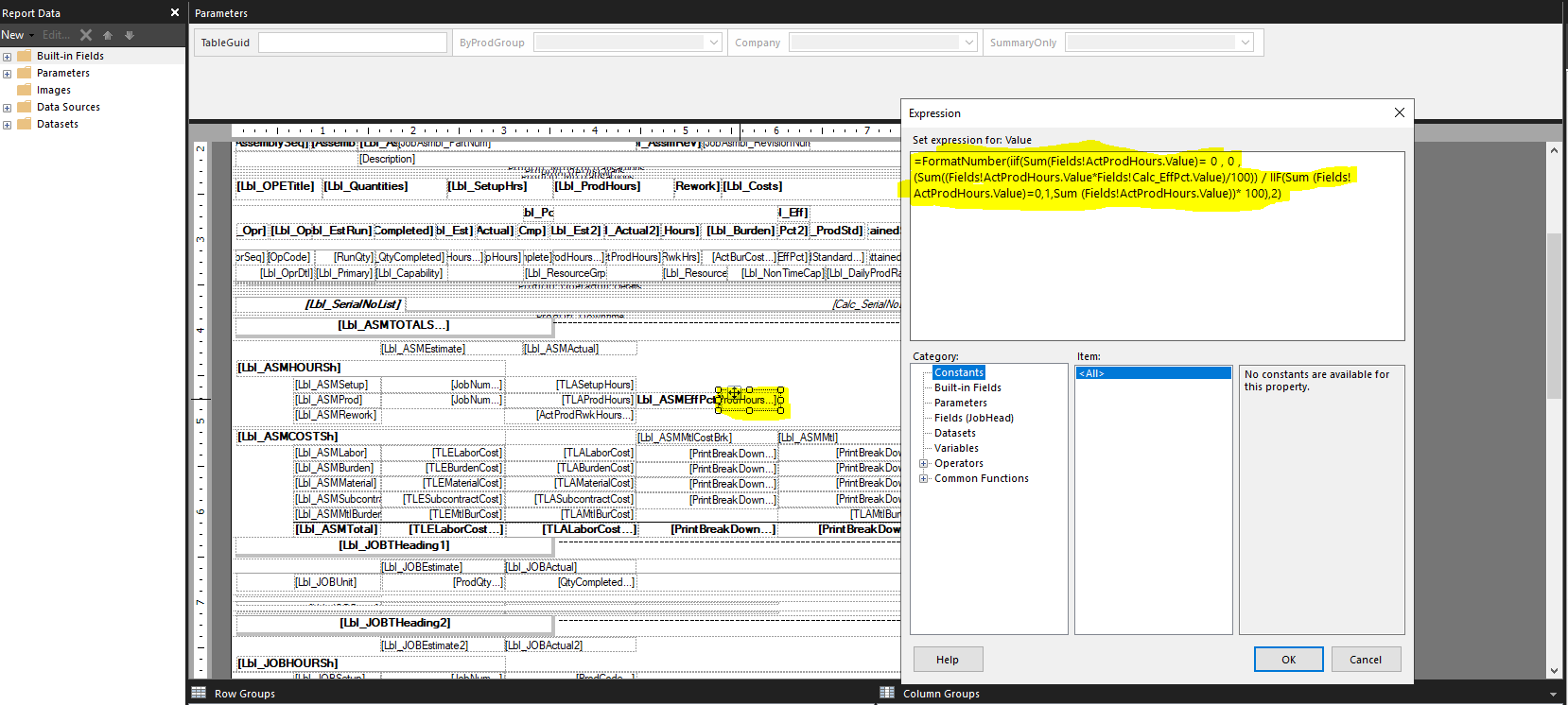

Now, if I see about how the report is set up, it is actually different. Any suggestions about how should it work ?
According to formula it should be around 538,…% but it is 303.46

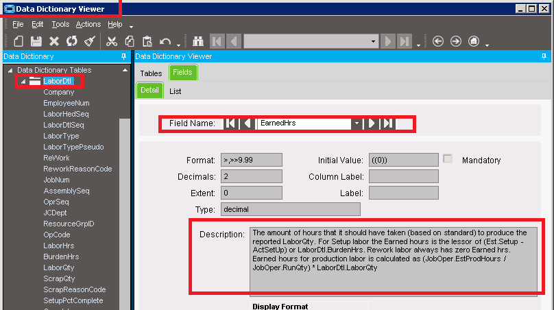

Thank you for your response. But how do we calculate Earned Hours ?
I use the Data Dictionary for LaborDtl.EarnedHrs
The amount of hours that it should have taken (based on standard) to produce the reported LaborQty. For Setup labor the Earned hours is the lessor of (Est.Setup - ActSetUp) or LaborDtl.BurdenHrs. Rework labor always has zero Earned hrs. Earned hours for production labor is calculated as (JobOper.EstProdHours / JobOper.RunQty) * LaborDtl.LaborQty
