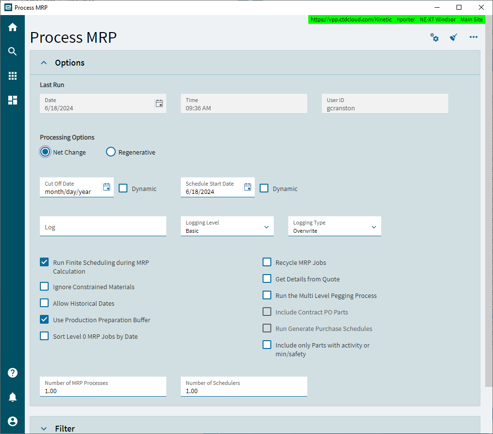

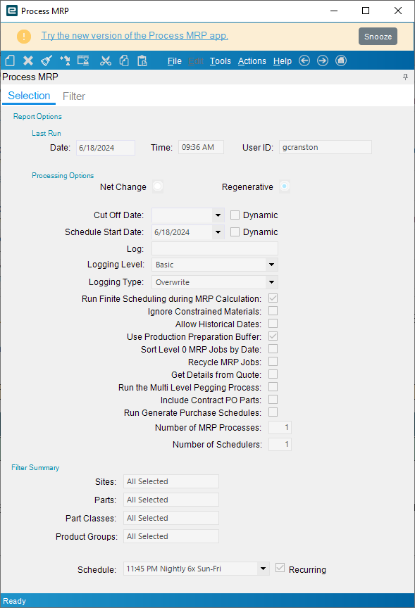

After upgrading to 2023.2 we are finding that depending on which interface we use to view details of a Schedule Task for Process MRP we get shown different information.
For example, in the Classic smart client view we see a specific scheduled task as having “Regenerate” option checked, but if we then click on the link in the window to “Try the new version of the Process MRP app” to get to the same record in the Kinetic interface, it then is shown with the “Net Change” option selected.

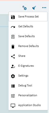

I bet the Classic or Kinetic UI got it’s defaults saved once upon a time, and now that’s what’s populating the form.
You can override the native settings by going to Actions (in Classic) or … (Overflow in Kinetic) > Save Defaults to save whatever you’ve got set in the screen.
If you delete the personalization (in Classic) or delete the personalization layer (in Kinetic with a data fix), it should revert to the native settings.
It looks like the issue is that the Classic smart client correctly shows the details of the Process MRP scheduled task when you open that through the smart client System Monitor, but when the same record is opened in Kinetic it actually opens the generic “Process MRP” screen where you can configure and run an ad-hoc run. What the users are seeing in Kinetic is therefore nothing to do with the scheduled task for Process MRP that they had thought they had opened and is simply showing the default parameters for any ad-hoc run we might want to run.
There doesn’t appear to be a way to view the details of a scheduled Process MRP task in Kinetic, but confusingly to users it looks like it does (but in fact it shows default settings).
It looks like it has to be done in the Classic smart client interface.
