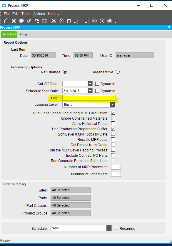

You should of set up a path when kicking off MRP. If you did not you will not have a log file. Other wise mine go to here…\{my appserver}\EpicorData\Companies\TASC\Log\manager\MRP_NetChng.log

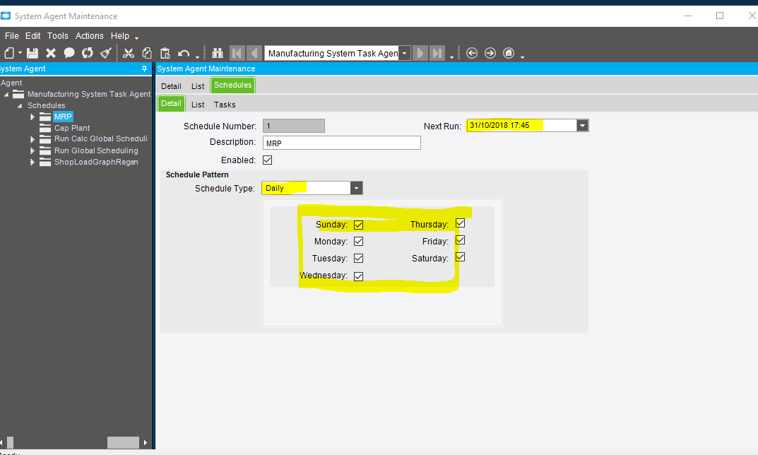

if it appears again as active and stuck there for long time as you explained, it means that it has been triggered again by the task scheduling or manually (you need to take control of this and stop all users from running this process), then i suggest to go to the system agent and disable it there (i,e. remove the scheduled task or disable it), then log on your epicor server Epicor Administration Console / server management then Task Agent Configuration and stop it then start it, however this will kill all active tasks including printing.
you need to specify the path and your log file name where i highlighted, at least run the process after setting the log file path and name, then after killing the process using the method i suggested, then you need to go open the log file and check why it has been stuck and at what stage

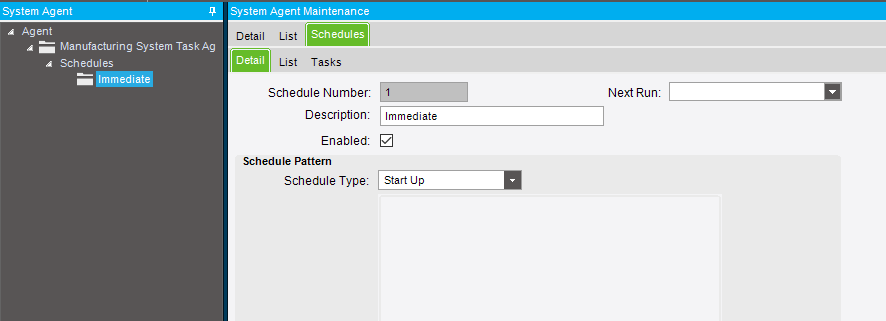

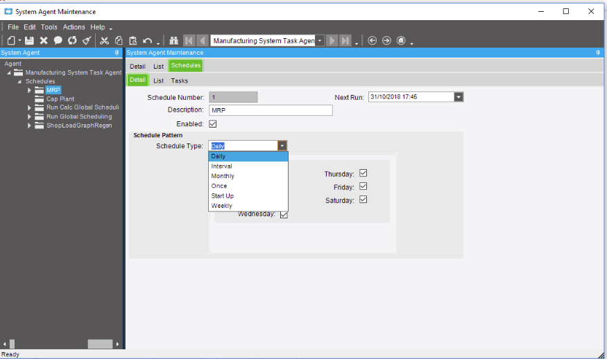

never used this option, could be why it starting at each system start up, change it to once or daily and add the log path and name as i suggested and see.
As you recommended i have changed the task agent properties and restarted the same.

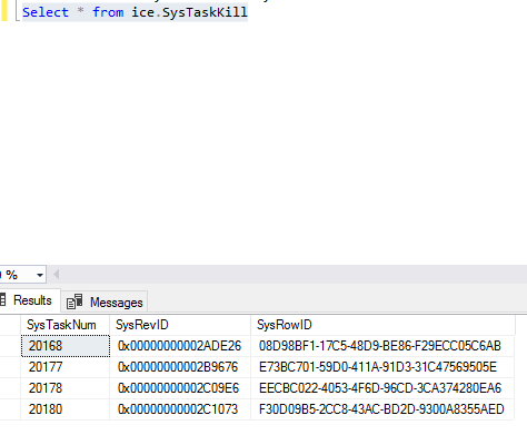

I found this table holds foreign key for Systask is something need to be deleted here.
