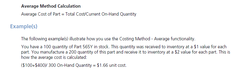

Otherwise, it seems like tha math is pretty simple. The Job Costing Tech Ref says:

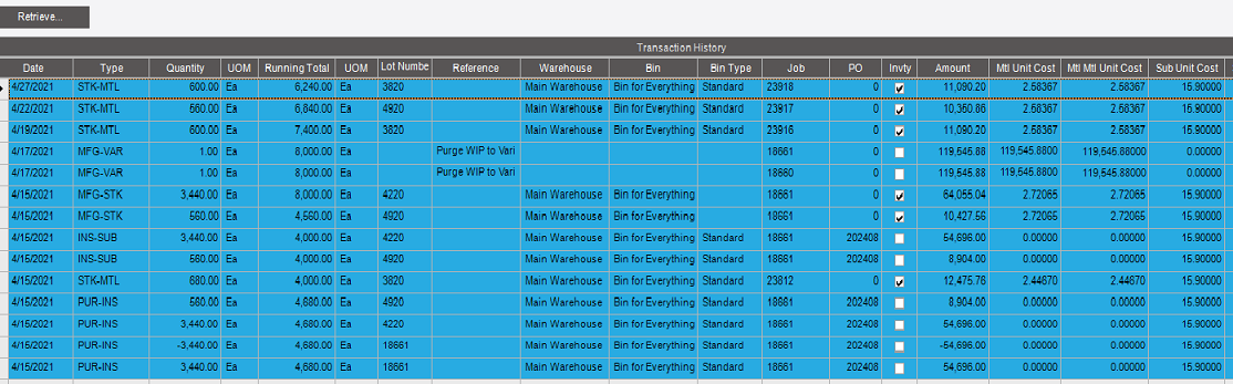

I’ve attached a snapshot for Part A of A,B & C. My apologies if it doesn’t work.
Yeah, wow. It’s got $14.94 per part going to variance (all material - no labor, etc.). And yet you have no transactions showing for the period of two days after MFG-STK and before MFG-VAR.
I thought maybe it’s labor, as that does not show in PTHT. And it says it’s all material.

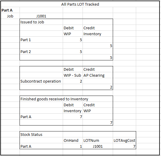

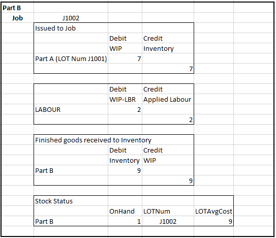

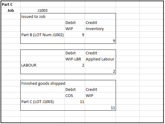

The final product costing will be averaged out since the “Average costing” is used.
I believe if you enabled LOT track with LOT Average costing you will achieve your result.
