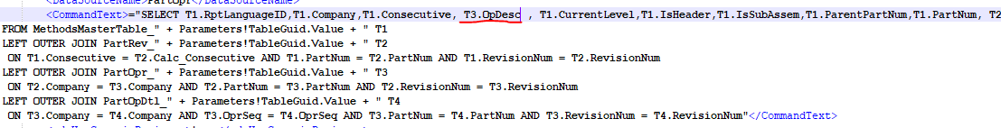

The best way I found to get around this was to open up the .rdl file using a program called Notepad++. This will allow you to modify the data expression without running into the character limitation.
When you open it up youll look for the select statement that doesnt mention literals/labels. From there you can add tables, relationships, and fields as needed. Below is a screen shot of what it looks like in a subquery of our MethodMaster report.
Note that you will have to make these modifications to the the report/subreport in question, not all parts of the report.
An additional thing I would like to ask is if you used the Sync Dataset button on the report in question. If so that is what was diagnosed to be the problem with the report I was struggling with in the past. The Sync Dataset greatly bloats data expressions.
