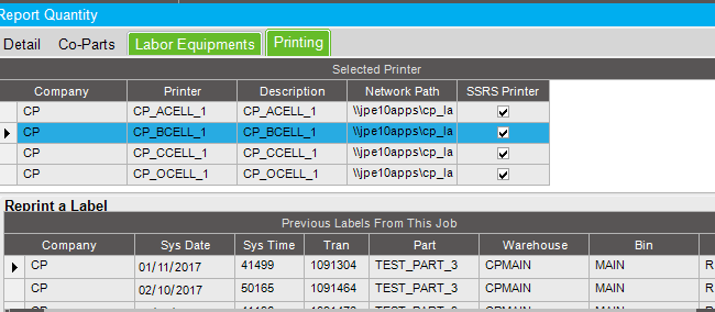

I do something similar with product labels that are being generated on Report Quantity.
First, I had issues with the standard tag printing, next I had issues with E10 interface with Bartender.
Ultimately, I ended up writing my own code to generate Bartender trigger files. I have written the code both for use in a BPM and customization.
For reprints, since the code is already in place to print a label based on values from the DB - all I do is give my user the ability to pick a previous transaction, and reprint.
I use a BAQ and show the last 30 transactions against a job (for MFG-STK only in my case) - this shows in a grid which the user can click to reprint (they also have options for which printer and number of copies - both which are part of the bartender file)
(The printer defaults based on workstation, but the user can change it if desired)
