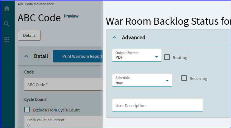

I have a “War Room Report” which I have an application for (Menu Maint. image below):

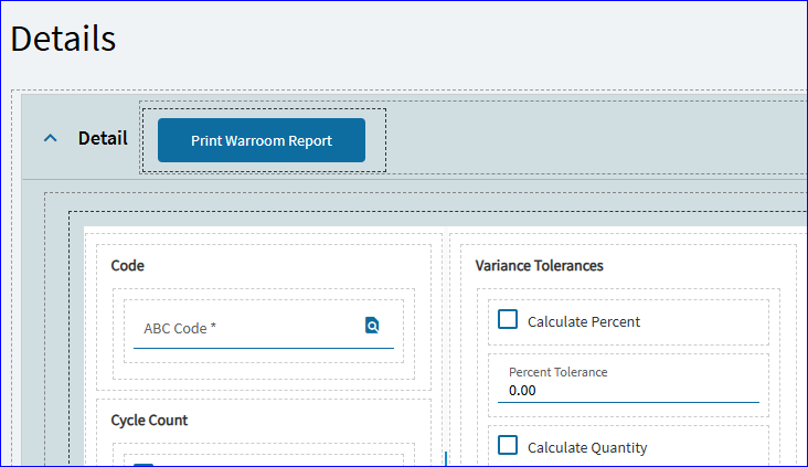

Add a button on the form where ever you want/need it:

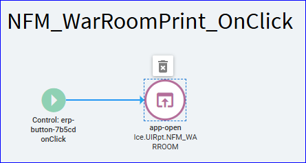

Add an onclick event (behavior) that calls app-open with the report’s application as the target:

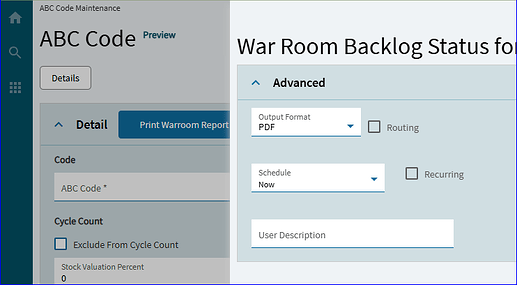

Preview:

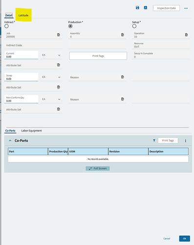

Thanks for the replies. Here is some more detail about our current classic UI customization. It is on the “End Activity” screen that is launched via MES as a custom separate tab. The custom tab has a number of fields that default to info pulled from the current job/operation that our shop floor operators are ending. They can override this data with search buttons. Once they have all the required and optional fields filled out they then click on another custom button on the same screen to “print” a shipping label. This then brings up the MS Windows print dialog box where they can select from a list of installed printer objects. This is just the base MS Windows print dialog, nothing to do with Epicor/Kinetic. Behind the scene the values that they entered into the custom fields are passed to a SSRS form and that is what prints.
I need this same functionality to work in the Kinetic web UI. The developer that I’ve had working on this has been having issues getting the same printing workflow to work. Please advise.

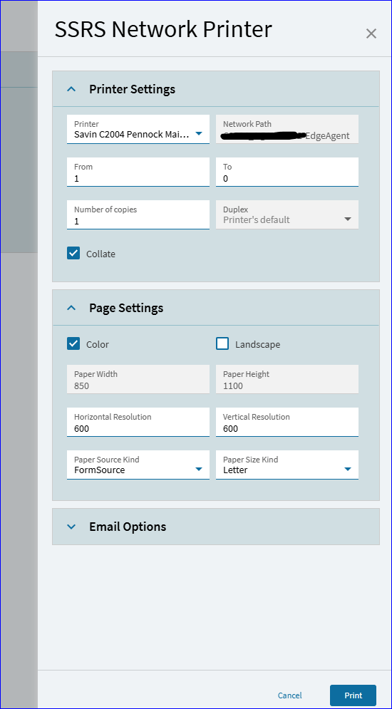

Typically in the overflow menu, there is an option to “Network Print”
This opens a Network Printer dialog and you can choose from printers you’ve added as network printers within Printer Maintenance.
I don’t know that there’s a way to get the MS Windows print dialog back as a whole.
