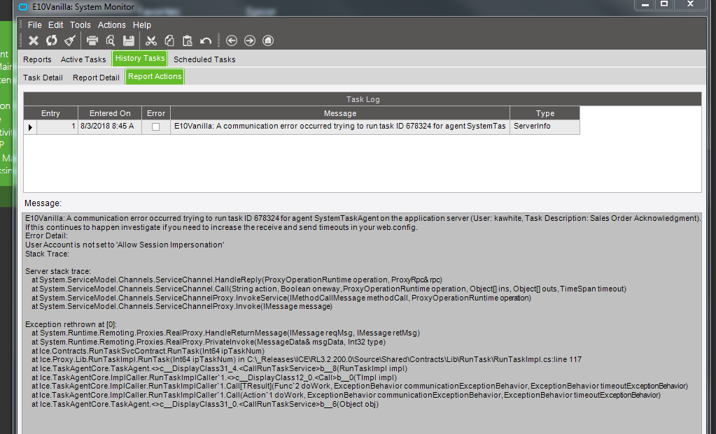

We just set up a E10 and a new AppServer. All my print jobs are stuck in Immediate Run. I have recycled the Application Pool…still no luck. Not sure why it is stuck. Maybe I set something up wrong…
As I was typing this I closed E10 and opened back up to check it and now have some more info. But why do I need to set all user accounts up to ‘Allow Session Impresonation’?

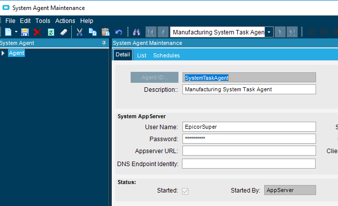

Hey there have you checked the task agent and made sure that is is running for your database, you might need to restart it.
You only need to have 1 user, normally manager setup as “allow session impersonation” and this user is setup in the task agent , and system agent, your normal users do not have to have this box ticked.

Yup that was it… It is working now. UGH. totally missed that.
just curious do yo have the Task Agent user and the Admin Console user set the same?
Yes we do have the same user in both.
