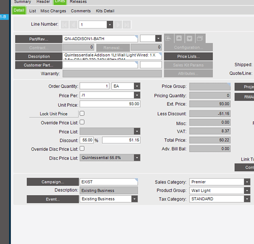

Hello I made a price list set for discount percentage based on line break and attached it to a customer it agknowledges the price list but does not pull in the 55.8% discount only the 55% set at customer level

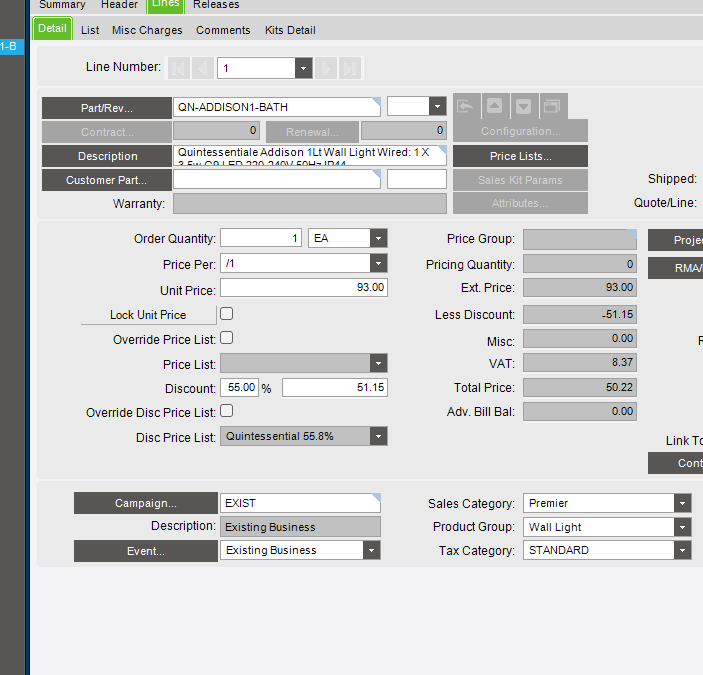

Was the 55.8% discount break set to occur at a quantity greater than the (1) unit being ordered in the screenshot?
