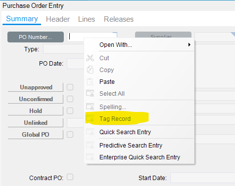

Are you familiar with Data Tags?
On most key fields, if you right mouse click, you’ll see “Tag Record.” This will add a given tag to the record.
Now, in Method Directives, you can look for that Tag and block the method.
Later, you can remove the tag when receiving can occur.
You could use the same type of BPM but on the POHeader.OrderHeld instead of a Data Tag and put an Exception Mesage that tells the receiving user to contact the Buyer for review.
