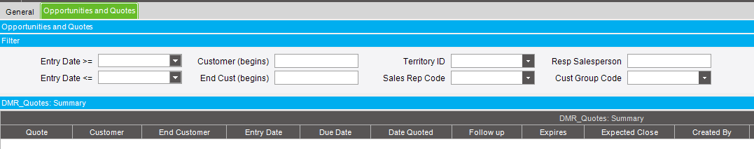

There’s a fantastic little workaround for the date range. I’m actually about to make a YouTube video about it. Long story short, make a calculated field on your BAQ and set it equal to whatever the date field you want the range to. Then in your dashboard tracker view, you’ll have two columns to use. Set one to be LTOE and the other to GTOE. You can edit the label right there in the Properties screen and then there’s no need to use customize tracker view - which keeps it nice and easy to edit should anything change in the future. Hide the calculated date field in your data grid (otherwise people are like why is that in there twice).
But the only way I know of to lock the position of the fields is to go to Customize Tracker View, which defeats the purpose of the cool little workaround I figured out. So I was hoping to find the missing piece of the puzzle here. There’s a way. I can feel it.
