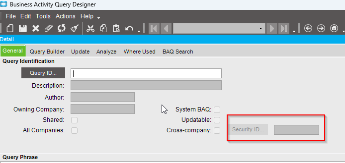

How do I set up security for a BAQ?
If you are familiar with menu maintenance, create a new security id called BAQ1 or something similar, edit security to disallow access to the PowerBI user account.
On the BAQs you do not want the PowerBI account to access, add the Security ID you created. It’s a little tedious, but it works. The power BI account will not be able to see or use those BAQS in any way, including reports and dashboards.
