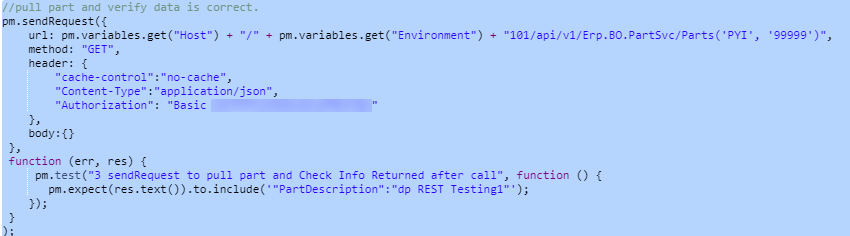

I’m not sure this is possible, but what I am trying to do is update a part field and then pull the part info and verify the field was updated and then repeat the process. I am using the odata from PartSvc
This sendRequest test works to pull the data after the initial update.
I then try to update the part again. This does not work!
I reviewed the calls in the postman console and the only difference I see is my second call is missing the body.
Any help would be appreciated.
