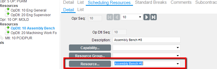

Unfortunately, this can no longer be the case as Resource groups are now a requirement and (from what I read) only 1 resource group can be assigned to a single operation. If this is correct, then my possible solution would be that each Specific product would have the specific resource group tied to that product’s operation, the resources would be the individual machine types needed for that product.
Example:
Product A -----> Operation 2: Assembly --> Resource Group Product A --> Unique machine type 1, unique machine type 2 …ect… ect
You can have more than one resource per operation. It does not have to be a resource group, as you can specify a resource instead of group. In Engineering Workbench you can override a default operation resource group or resource and specify a specific resource.

Keep in mind that you can set defaults in Operation Maintenance. You can add multiple resources in the Operation, so when it is used in the method, the resources will pull into the method as configured on the Operation.
