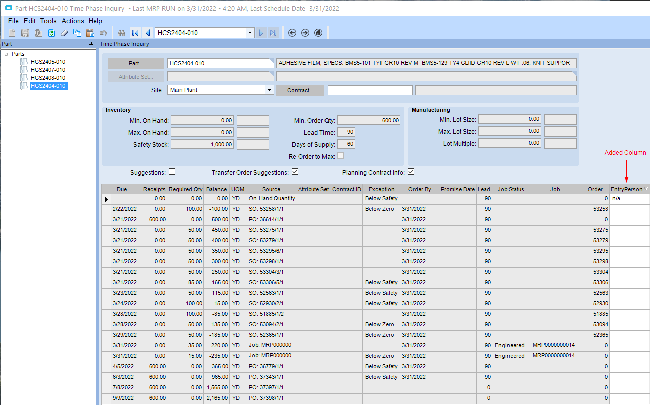

Populating Time Phase Grid with Sales Order EntryPerson
I am attempting to add a column for the sales order entry person onto the Time Phase Inquiry grid.
It appears that it is only returning the first row even though I have implemented a for each/next loop.
What am I missing?

Have you already seen this post?
No, I have not. I did search (quite a bit I might add) for related topics, but somehow this one escaped me. I will check it out. Thank you for the info!
