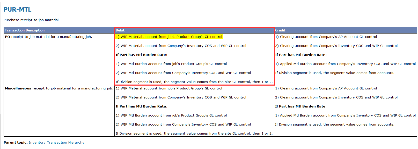

I was following this hierarchy from the “Inventory Transaction Hierarchy” that Ernie pointed out:
With no PG specified, it should have defaulted to the WIP Material Acct from Company’s Inv, COS & WIP GL Control
