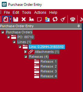

PO Suggestions creating multiple PO releases of the same part (We would want to create multiple lines instead). Is that possible?
Our Purchasing Department sent me a request to see if we could change the default behavior of the suggestions creating POs. If we select multiple suggestions with the same part, it creates one PO line with multiple releases. Supposedly, it’s causing problems down the line since it’s more complicated to follow / receive, etc.
Is there any option in the system to tell the system to create multiple PO lines each with 1 release? Otherwise, I’ll have to look at the possibilities via coding which is not ideal but I guess that’s doable
In this example, I had 4 suggestions:
  • Purchase Direct for Job1
  • Purchase Direct for Job2
  • Inventory for Job3 (Warehouse1)
  • Inventory for Job4 (Warehouse2)

With this example at the end, you’re talking about purchasing suggestions. It’s already the case right now, I had 4 different PO Suggestions. However, when buying them all at the same time, it generated 4 releases
