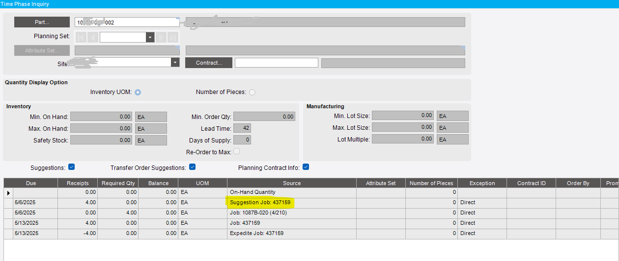

Hi, we are missing a few bunch of subcontract operations in PO Suggestions. I have checked everything I could.
  1. Job is scheduled.
  2. Part is Non-Stock, Generate PO Suggestion, Run MRP, and etc.
  3. Regenerated PO Suggestion for hundreds of times.
Here is the screenshot of Time Phase. It shows a suggestion, but I could not find the suggestion in PO Suggestion. Any thoughts?
In PO suggestions you have to switch from material to subcontract at the top of the screen to see the subcontract suggestions. They do not show up in time phase period.
How would one present it in Time Phase? Receiving a subcontract line (or lines) doesn’t affect the quantity of the finished goods like its job would. :thinking:
I have done a customization to pull in the subcontract PO number into the time phase grid as an additional column next to the job. The reason this works for us is because we only ever have a single subcontract PO for the job. In a scenario where you have subcontracts for lower level ops vs. the final asm this wouldn’t make sense.

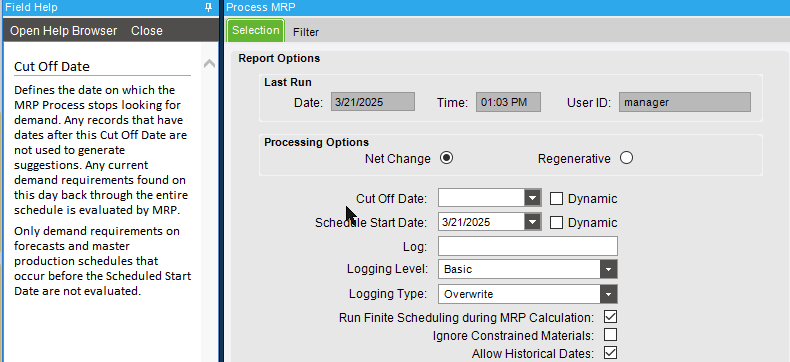

Did you try pushing out your cutoff date? Demand is for 5/6. I think the cutoff date of today is going to mean it doesn’t look out past today.
Good catch! You can have the schedule start date as today. Leaving the cut off date blank will go out 10 years.
Brandon,
Thanks, that’s the issue!!!
You saved my weekend. :heart:
