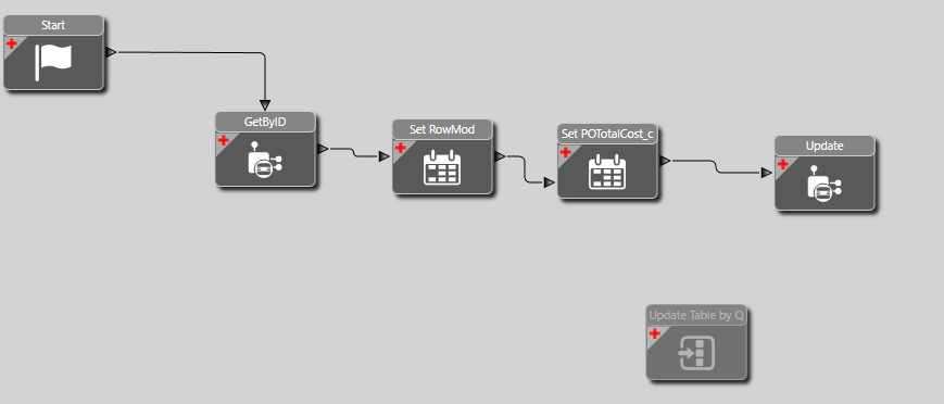

I then created the following function:

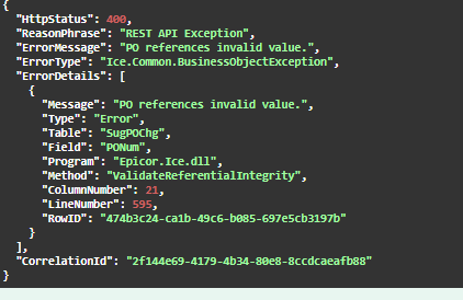

and get the following error:
I have checked, and the tableset values are OK prior to the update (i.e. PONum references a valid purchase order).

I thought it would be very straightforward and the code is something I coded before and constructed with widgets on other BO’s (i.e. GetByID, make the changes and then Update).
