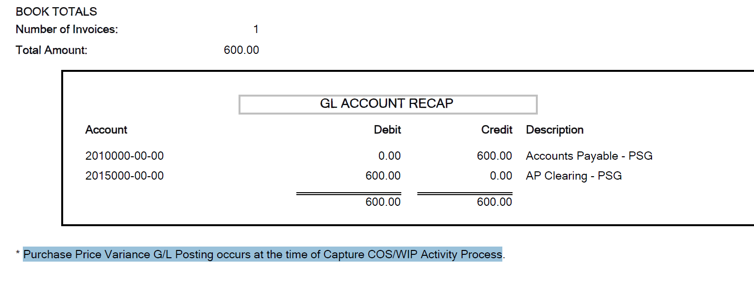

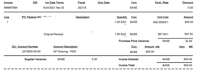

Here is a test example where the invoice came in for $600 but the receipt was entered for $567.50, a variance of $32.50. You are correct that the full $600 is going to AP Clearing, but at the bottom of the edit list, it also notes “Purchase Price Variance G/L Posting occurs at the time of Capture COS/WIP Activity Process”

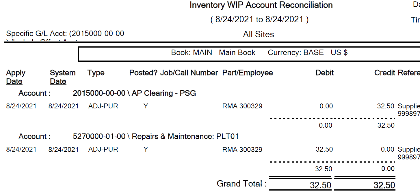

In fact, after posting the invoice, AP Clearing is off by that variance. However, the Inv/WIP Report also shows the offset coming out of AP Clearing and applying more cost to the expense account on the PO receipt.
And Chart Tracker shows the variance accounted for in AP Clearing as a credit:
