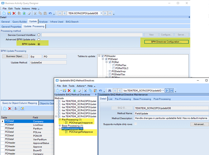

We have a similar need but for some personnel with low purchasing limits maintain po release dates on orders worth more than their limit. We use an updateable dashboard to provide access and update to the PO releases. See screenshot below. When the unapprove and reapprove occur, you need to deal with:
ReadyToPrint , Approve and ApprovalStatus

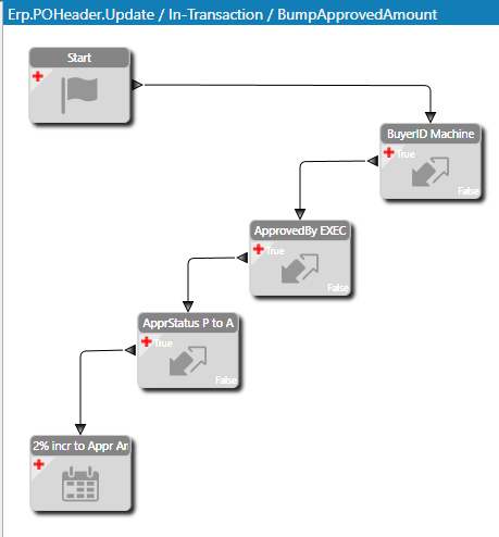

As suggested by @enbw, you can update the Approval Amount when user re-approves after changing the price in PO.Update Method Pre-Processing when Approve is set from false to true.
@Arul thank you for the tip. It got me thinking about how I wanted to proceed. I decided to use an In-Transaction data directive on the PO Header. My data directive checks that we have the correct buyer, that the approver is our Executive, and that the approval status goes from ā€œPā€ to ā€œAā€ (pending to approved). When those 3 criteria are met, then it takes the ApprovedAmount and multiplies by 1.02 (to give us a 2% buffer before a re-approval will be needed).

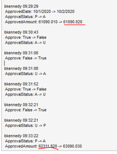

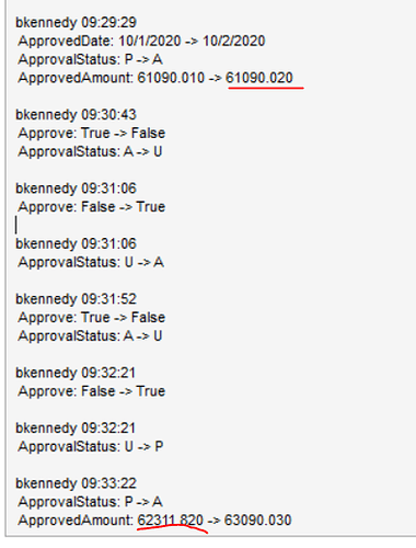

There are a couple of cool things that happen. The higher amount does not show up in the change log, but it is working. See the change log, previously approved amount of $61090.02, then bump it by 2% = $62311.82. Unapproving the PO, changing the price to anything less than or equal to 62311.82 can be checked to approved by the buyer. If the price is changed to an amount higher than this, then it needs to get re-approved (and then that new approved amount will also be bumped up by 2%).
