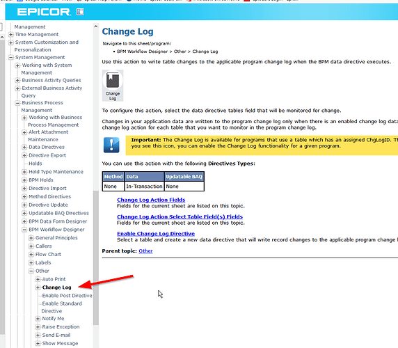

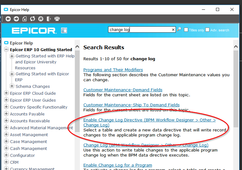

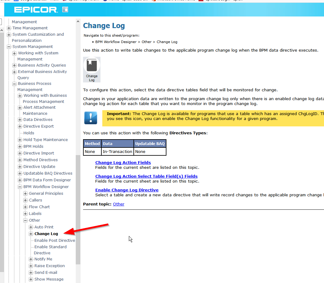

For setting up a change log, the help files actually do a really good job walking you through how to set them up. It’s a data directive BPM. Search your help for change log, and click on the enable change log directive.
This is the help page for setting it up. You pick which fields you want to track.
That should get you started. Give it a shot and if you get stuck somewhere let me know.
