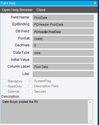

Field help shows:
“Date Buyer posted the PO”. What does this even mean? None of our buyers are aware of needing to post anything on their Purchase Orders.

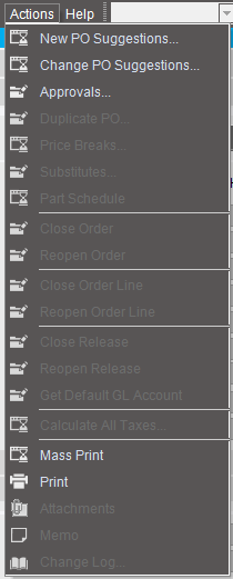

There are no actions on the PO to post at all:
