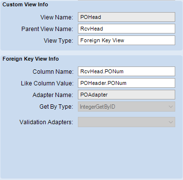

Add a Foreign Key View for the POHeader
Brian,
Thanks for the information, i will give that a try. Is there any other linking that needs to happen? And your screenshot is that what i should mimic or different values?
When I first read your post, I was thinking Comment, not Memo. If you create the FKV shown, the POHeader.Comment field will be available in the view. Not sure if a FKV to the memo table can be created.
