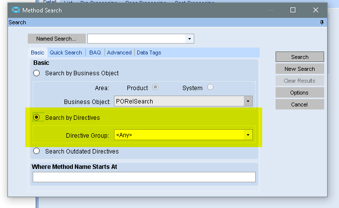

To disable the BPM,
  1. Launch Method Directives Maint
  2. Click the Method Code button to search for the BPM.
  3. In the Method Search window, select Search by Directives, Group (), and click search
  4. In the method column look for one containing PoRelBeforeUpdate. select it and click ok
  5. In the Method directives window, expand all the tree branches and go to each method and disable it (clear the Enabled checkbox)
  6. Save the Method, and see if the problem still persists
