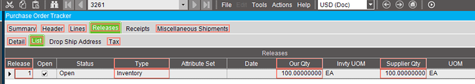

I am trying to correct the wrong unit price of PO. When I try to uncheck Approved, the message “Record in process, unable to update” below pops up.
This PO was issued until Receipt→AP Invoice. AP Invoice processed Debit, and Receipt was deleted. Nevertheless, the PO’s Approved is not unchecked.
Is there any other necessary action for this? Or is there another way?
